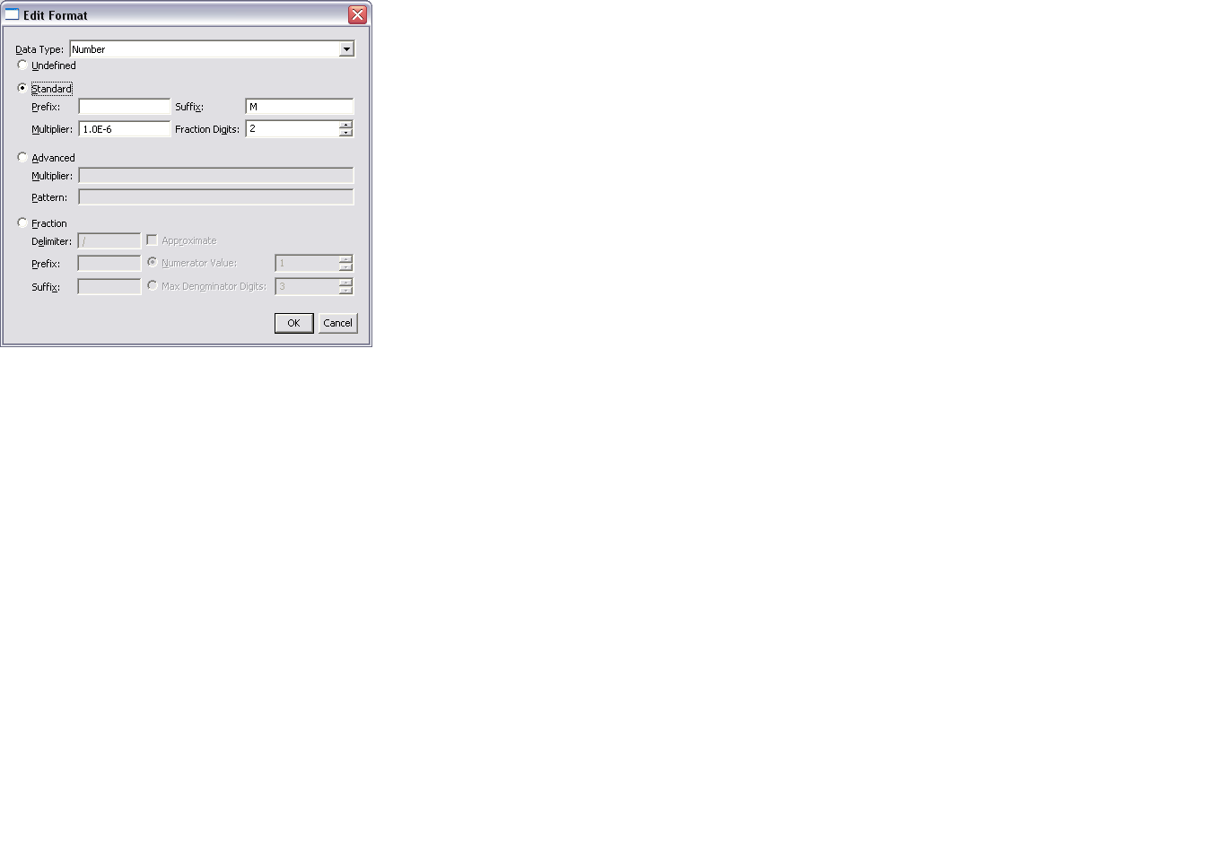

Re: Setting values for y-axis labels [message #153927 is a reply to message #153397] Mon, 17 April 2006 15:07 Go to previous messageGo to next message
You could do everything as k or m, but not mixing with the formatting UI.
For 10M, here is an example how to do it (see screenshot).
David

Re: Setting values for y-axis labels [message #154498 is a reply to message #153927] Wed, 19 April 2006 16:46 Go to previous message
Originally posted by: tmbyrne2002.yahoo.com
Thank you, that worked well enough to put it to the thousands (k), though
once our data starts getting in the billions the users will probably
complain but I'll cross that bridge when we get there. Thanks again!
