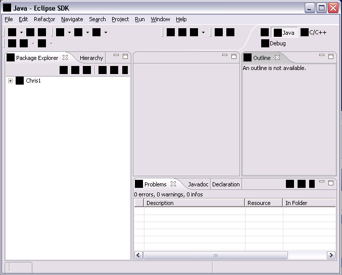

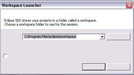

When I run Eclipse, the "Workspace Launcher" dialog has no text on the
buttons or the checkbox. If I choose the button that should say "OK", the
IDE opens up and all of the toolbar icons are black squares.
However, if instead I click "Browse" and choose a workspace directory (even
if its the same one), then the toolbar icons are fine.
I tried checking the "do not ask again" checkbox, and now my icons are
always blacked out.

Re: Buttons with no labels and toolbar with no icons [message #152244 is a reply to message #151846] Fri, 12 May 2006 11:22 Go to previous messageGo to next message
Originally posted by: programmer.nashclan.net
Screenshots attached.
