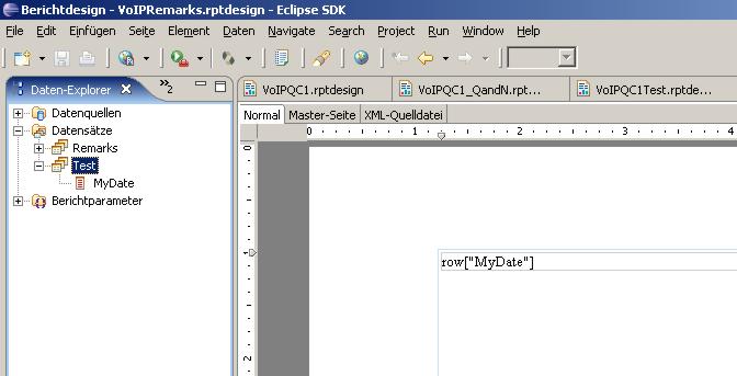

But if I drag/drop the MyDate field from data-explorer to the chart area
(see attachment birt1.jpg)

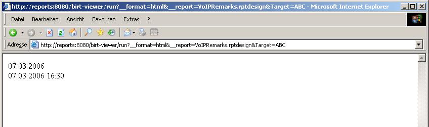

and run this report I get TWO lines back instead of ONE.
(see attachment birt2.jpg).
Under preview and HTML view out of eclipse environment and after deploying
it to e.g. JBoss, this error happens!
PDF output works fine.
Any idea whats wrong?

Re: Here is a nasty hack to get around the Major bug in birt dates. [message #140777 is a reply to message #140748] Tue, 07 March 2006 10:05 Go to previous messageGo to next message
Sorry the 2nd one comes from the masterpage, which is preset to use a date
on the footer of the page!
