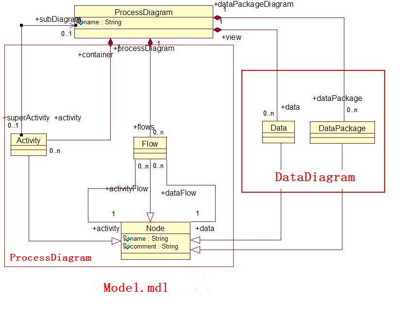

I want to to fulfill this fuction: In EditorA, I create a view with an
element called "data", when I double click this View, it will create a new
Editor EditorB, and create another view with the same element "data" In
EditorB.But it seems like that the view in EditorB does not listen to the
change of its element "data".

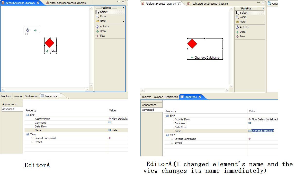

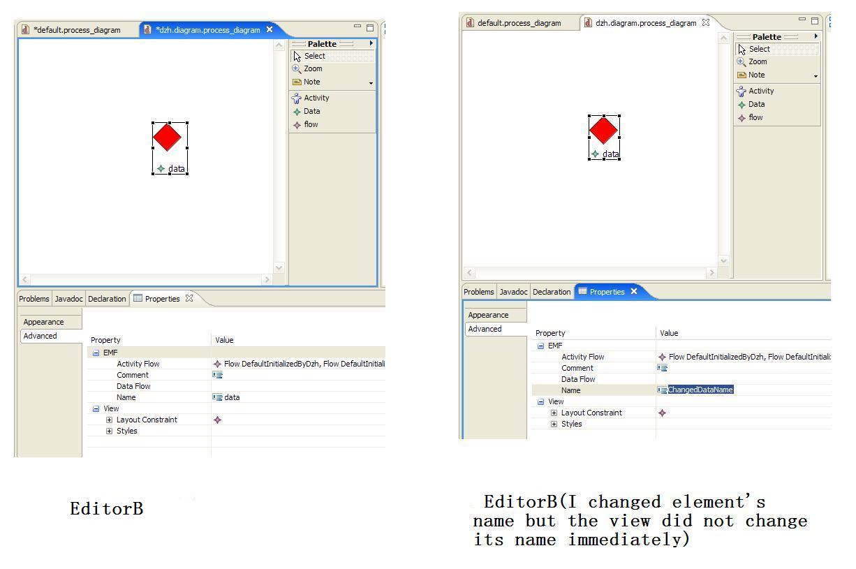

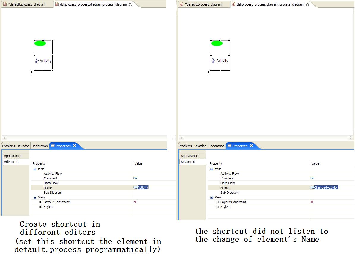

The problem is that,in EditorA, when I change the name of element "data" in
its property view ,the view changes immediately, but in EditorB, when I
change the name of element "data" in its property view, the view didn't
change at all, unless I refresh the EditorB manually.
It seems like that the view in EditorB does not listen to the change of its
element "data".

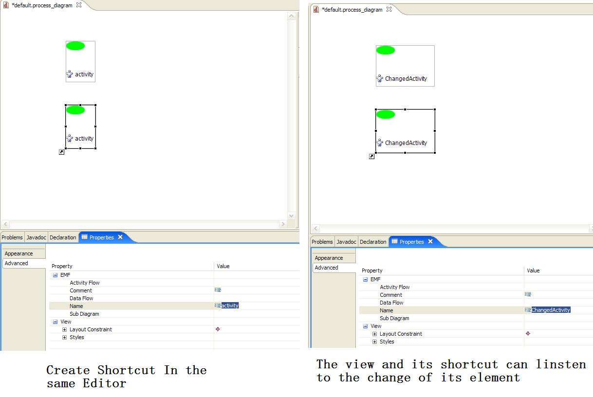

Re: problem with synchronizing model changes in different Editor [message #2251 is a reply to message #1310] Tue, 01 August 2006 11:03 Go to previous messageGo to next message
Originally posted by: dzhpingbo.sohu.com
I found that if I create Shortcut programmatically in the same editor, it
works fine:) The code below :
protected Command getOpenCommand(Request request) {
//Use the same Editor
targetDiagramEditor=(FileDiagramEditor)window.getActivePage( ).getActiveEditor();

But if I create Shortcut programmatically in different editors, it come out
the problem, the view does not listen to the change of the element. The code
below:

so I think i t must be "they are not using the same ResoureSet by both
diagrams" refers to Alex mentioned in
http://dev.eclipse.org/newslists/news.eclipse.technology.gmf /msg04116.html ,
Let me call my default.process_diagram as DiagramA and
dzhprocess_process.diagram.process_diagram as DiagramB.
> This could be the reason. In case there are two different editors keeping
> referenceing the same model element(s) you'll get two copies of the model
> loaded into the memory and changes will not be propagated from one copy to
> another one.
yes , I notice that, and in second situation - using shortcut in different
editor, I set the shortcut in DiagramB with the element which I just
created in DiagramA.
Sorry for not explaining clearly in my previous news.
CreateViewRequest.ViewDescriptor viewDescriptor = new
CreateViewRequest.ViewDescriptor( new EObjectAdapter(actImpl ), Node.class,
null,
//the actImpl is the element I just created in default.process_diagram, I
want to creat the shortcut using the element from DiagramA
ProcessDiagramEditorPlugin.DIAGRAM_PREFERENCES_HINT);
If I select element on DiagramA and change something in a properties view
for this element , the shortcut( I create it programmatically using the
element in DiagramA) in DiagramB does not listen to the change, unless I
refresh it manually( I have to double click on the shortcut's name and it
will reflect the change of element in DiagramA).
If I select shortcut on DiagramB and change something in a properties view
for this shortcut , the element in DiagramA is updated immediately without
needing to update it manually, but the shortcut I selected in DiagramB does
not listen to the change in the properties view.
But if I create the shortcut using the element I just created in the same
editor, it works perfectly, either change something in a properties view
for this shortcut or in a properties view for the element, both the shortcut
and the element update immediately.
I don't know why?

Re: problem with synchronizing model changes in different Editor [message #2498 is a reply to message #2343] Wed, 02 August 2006 08:06 Go to previous messageGo to next message
Hello dzh,
Looks like currently I understand what’s happening in your situation. I’ll
try to explain it below.
> ActivityImpl actImpl = ... ; //get the ActivityImpl is the element I
> just created in DiagramA
I suppose that here you’ll just get an element you have received from CreateCommand.
This element was loaded into ResourceSetA associated with DiagramA and has
no connection with ResourceSetB associated with DiagramB. In the same time,
DiagramB is listening only for a changes made in ResourceSetB. To create
shortcut working as GMF shortcuts you have to load created ActivityImpl into
ResourceSetB, get corresponding EObject and pass it to the CreateView command.
You can take a look on generated ?CreateShortcutAction. run(IAction action)
method (see http://wiki.eclipse.org/index.php/GMF_GenModel_Hints#GenDiag ram,
“Contains Shortcuts To” and “Shortcuts Provided For” properties). In this
method selected element will be loaded using it’s URI into the correct ResourceSet.
I have to mention that even if you correct this inconsistency, you’ll get
the situation which I’ve described in prev. post (element modified on diagramA
will be updated only on diagramA same with diagramB). If you’d like to synchronize
changes across diagramA-diagramB you should either write your synchronization
code manually or share same EditingDomain instance across diagramA-diagramB
editors (see http://dev.eclipse.org/newslists/news.eclipse.technology.gmf /msg04116.html).
Alex Shatalin
