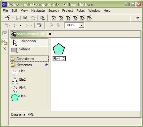

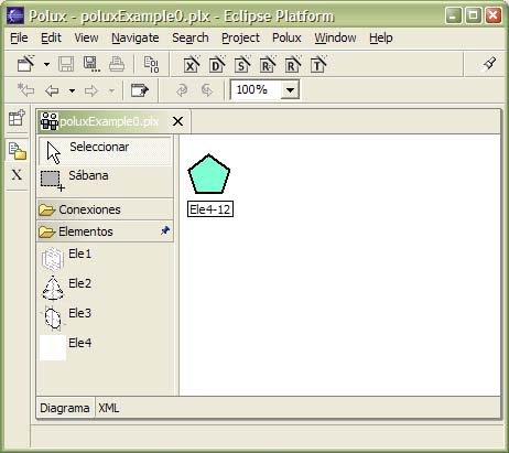

Things go quite well but I have some very anoying problems:
1) When the editor comes up the correct Icon is not shown in the palette
entry until I hover the mouse cursor over the corresponding entry, until
that only a white square is shown. See attached Fig1.jpg.
2) The background color of the source figure fills all the image not simply
the figure. See attached Fig2.jpg.
3) If the figure has a null font a NullPointerException is thown.
Any hint to solve at least the first problem.

Re: Problems with Thumbnail [message #133913 is a reply to message #133616] Mon, 24 May 2004 14:59 Go to previous messageGo to next message
There are certain triggers (repainting of the original figure might be
one....you can look at Thumbnail and figure it out) that cause the thumbnail
to update. My conjecture is that no such trigger is fired once the
Thumbnail is created, and hence the image is not yet painted upon. You can
simply try invoking thumbnail.repaint() once it is created, or you can
manually set off one of those triggers that would cause the thumbnail to
update.
