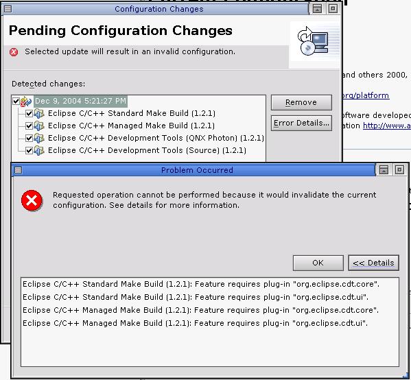

I'm trying to install CDT 1.2.1 on Eclipse 2.1 I'm doing this
because I'm using QNX and as you know Eclipse 3 is not supported for QNX.
I've downloaded the following accumulative version of CDT from here
( http://update.eclipse.org/tools/cdt/updates/release/dist/cdt -1.2.1.zip)
I've unpacked it to the "/" directory and found 2 folders "features" and
"plugins"
I've moved them to "/opt/share/eclipse/plugins" - where I have all my
eclipse files.
However when I start eclipse I see pending configuration changes (see
attached
screenshot as it contains all debug info I have right now)
Can you please help me as I though that i've downloaded everything I need in
order to run CDT plug-in in eclipse
Thanks a lot,
Roman.

I think your problem is that the "features" folder you got out of your
zip needs to go on top of /opt/share/eclipse/features.
So the end result is something like:
/opt/share/eclipse/features/org.eclipse.cdt.*
/opt/share/eclipse/plugins/org.eclipse.cdt.*
-Andrew

Could this be a permission problem? i.e. In my Linux if the normal user has
no read permission to the files.
