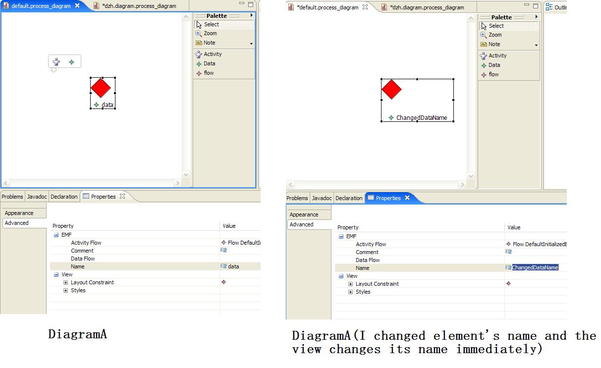

I created two Diagrams , DiagramA and DigramB with the same metamodel. I
want to to fulfill this fuction: In DiagramA, I create a view with an
element called "data", when I double click this View, it will create another
view with the same element "data" In DigarmB.
The code is listed below:
first, I installed the editorPolicy in NodeEditPart:
installEditPolicy(EditPolicyRoles.OPEN_ROLE, new OpenEditorEditPolicy());
Second, I overwrite the getOpenCommand() method of OpenEditorEditPolicy:
protected Command getOpenCommand(Request request) {
CreateViewRequest.ViewDescriptor viewDescriptor = new
CreateViewRequest.ViewDescriptor(new EObjectAdapter(data), Node.class, null,
ProcessDiagramEditorPlugin.DIAGRAM_PREFERENCES_HINT);
CreateViewRequest cvRequest = new CreateViewRequest((viewDescriptor));
Command cmd =
targetDiagramEditor.getDiagramEditPart().getCommand(cvReques t);
return cmd;
By doing so ,I can create different view in two diagram with the same
element .

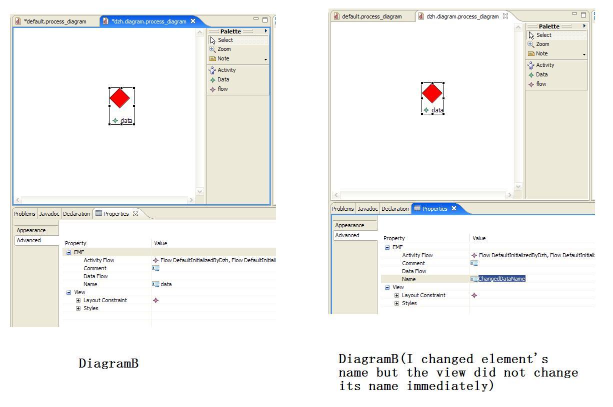

The problem is that,in DiagramA, when I change the name of element "data" in
its property view ,the view changes immediately, but in diagram B, when I
change the name of element "data" in its property view, the view didn't
change at all, unless I refresh the DiagramB manually.
It seems like that the view in Diagram B does not listen to the change of
its element "data".
It must be something wrong. And I was hold up by this for quite a few days,
looking forward to your answers.
By the way, does I set the parameter 'new EObjectAdater(selectedElement)'
right, or it should be something else?

  • Attachment: DiagramB.JPG
    (Size: 86.21KB, Downloaded 187 times)
  • Attachment: DiagramA.JPG
    (Size: 87.77KB, Downloaded 172 times)
