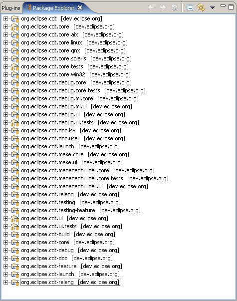

Hi Fabi,
From these projects i build CDT every day and it works.
I use export deployable features to build it.
Also maybe you don't use eclipse SDK version for building it?
As I see dependency for org.eclipse.swt is not found.
Vaidotas

Actually I was wrong. I want to add another debugger so I started by
copying
cdt.debug.mi.* and using it as a template. I changed some names (like
package,
classes, etc) but though I didn't change the code itself eclipse now has
dependencies to other plugins. But the real cdt plugins seem to be fine.
I don't know how this happened, maybe I just start over again...
Sorry for the noise.
bye Fabi
