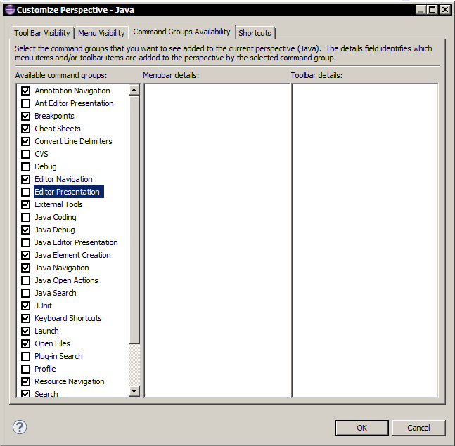

I also wanna customize my perspective, specially the toolbar. It works but:
index.php/fa/10925/0/
as you can see, there are no entries at "Menubar Details" and "Toolbar details" regardless of which category is selected.

Re: No Customize perspective in Juno ??? [message #899070 is a reply to message #898853] Mon, 30 July 2012 09:24 Go to previous messageGo to next message
Enrico-
I will look into this a little today and see what I am able to find. I can say that there is still a mix of commands & actions used by the workbench which may interfere a little. Also, it does not look like all command categories are being reported to the model (mere observation of the live model).
Primarily though, there still isn't a defined "editor" in Eclipse4, this will be one of the major feature enhancements in 4.3.
What I will look into more is the interoperability of 3.x plugins and the 3.x editor through the compatibility layer. There may well be some missing parts on the compatibility layer that are causing your issues. (Assuming you are using the compat layer).

Re: No Customize perspective in Juno ??? [message #899400 is a reply to message #899088] Tue, 31 July 2012 13:01 Go to previous messageGo to next message
Enrico-
Effectively, the issue is that the 'available command groups' points to the old actions registry and not to the model. Thus when the list of menu contributions from the application model is filtered against the selection, all of the elements are filtered out.
I am not familiar enough with the code to solve this issue right now. But this is a valid bug, please file a bugzilla [1] with your general description from above and paste a link to the bug here. I can only speculate, however I wouldn't expect to see any movement on this until 4.2.2 at the earliest (February).
