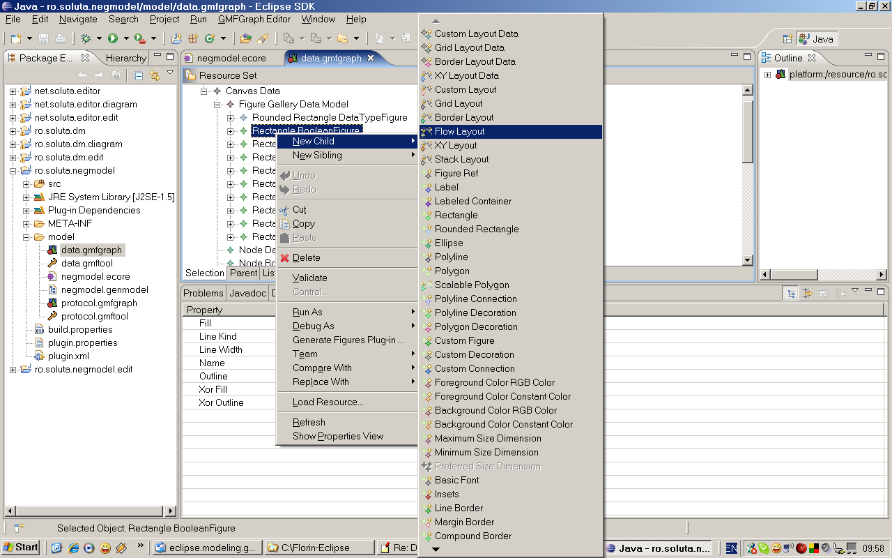

> FlowLayout layout child. This option doesnt appear under my rectangle
> figure properties. I have
This is a child element of figure in .gmfgen model - you have to create it
using popup menu on RectangleFigure.

Re: Double click feature and canvas mapping [message #114798 is a reply to message #114737] Tue, 27 March 2007 13:10 Go to previous messageGo to next message
Originally posted by: mcglinnk.cs.tcd.ie
Hi Alex,
I dont think you have explained where I can find that popup menu, it
doesnt appear to be in my rectangle figure in .gmfgraph and it doesnt
appear to be anywhere in my .gmfgen, as far as I can understand from your
reply I need to create it in .gmfgraph to appear in .gmfgen? I gave you a
list of everything that I have in my .gmfgraph in the last message, and
there is no popup menu to do this.

Re: Double click feature and canvas mapping [message #114841 is a reply to message #114798] Wed, 28 March 2007 03:01 Go to previous message
Originally posted by: fbanica.soluta.net
For the Flow Layout, make right-click on the rectangle figure, select
NewChild/FlowLayout (see attachment - I hope it's allowed put a .png in the

"Kris McGlinn " <mcglinnk@cs.tcd.ie> wrote in message
news:b8a38a50805067237b6d2adf6c88db45$1@www.eclipse.org...
> Hi Alex,
>> it
>> The best place to gen an information about .gmfgen model
>> properties/elements
>> is gmfgen.ecore file. ;-) In addition we have the following pages on the
>> web:
>> http://wiki.eclipse.org/index.php/GMFGraph_Hints
>> http://wiki.eclipse.org/index.php/GMF_Documentation
> Thanks!
>> AFAIK, we have an examples for only top-level elements. Try debugging the
>> generated code deeply to get an understanding why diagram is null. Take a
>> look on the element passed to ViewService.createDiagram and compare it
>> with
>> the element passed to the same method on opening diagram for top-level
> diagram
>> node.
> I will give this a go when I have some more time and let you know how I
> progress,
> Thanks,
> Kris.
