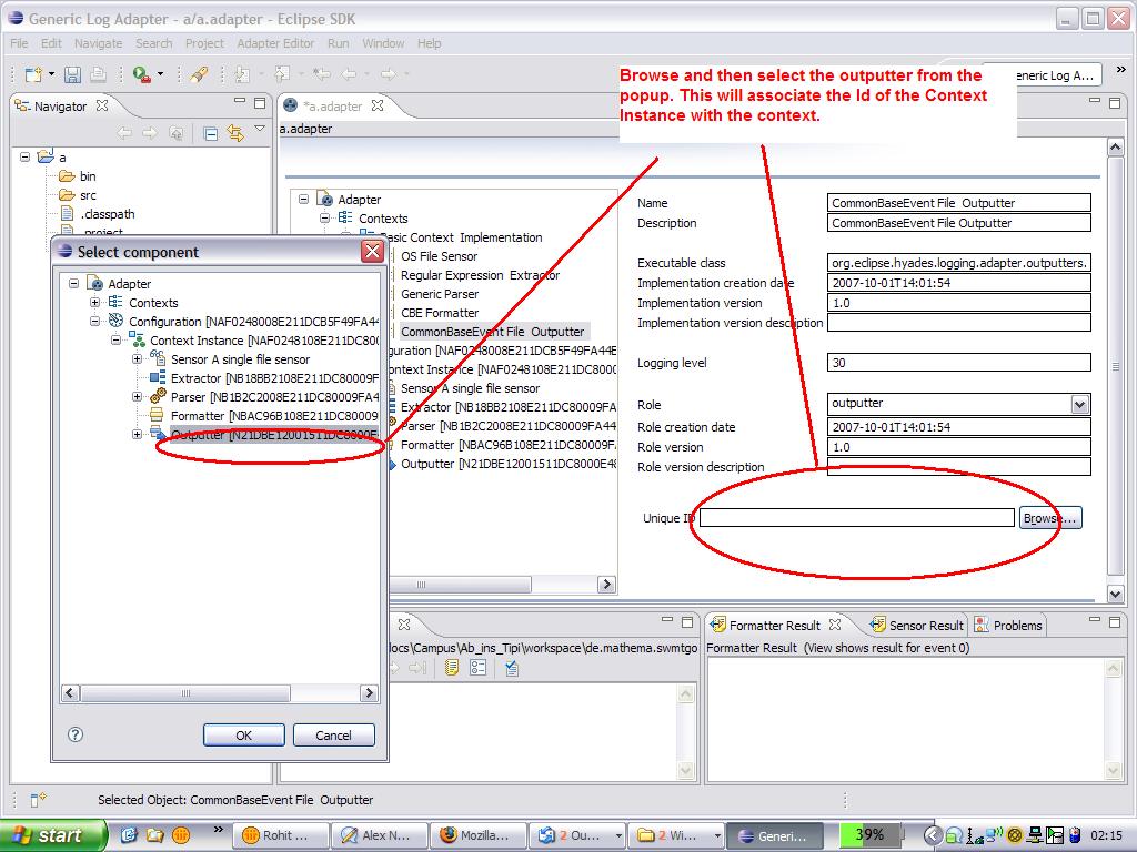

Re: GLA: translate custom log to CBE format [message #114413 is a reply to message #114031] Fri, 05 October 2007 16:48 Go to previous messageGo to next message
Hi Matthias,
I noticed that you have actually not associated the Context for the CBE
Outputter with the Instance in the configuration. I have attached a
screenshot that should tell you how to do it. I have also modified the
adapter for these changes.
Let me know if this works for you.
Rohit Shetty

Re: GLA: translate custom log to CBE format [message #115236 is a reply to message #114397] Thu, 11 October 2007 03:47 Go to previous message
Originally posted by: matthias.goettler.mathema.de
Hello Dave,
I originally tried to create the adapter file using the eclipse editor for
this file format. I have had a look at the raw XML, but only to see
whether there are obvious differences in the part defining the input file
and that for the output file.
Apart from that, I have been adding and removing various types of
outputters, e.g. that for System.out.
I also thought, I had tried adding the ID via the UI, and thought that
this also had not worked.
Anyway: the ID has to be set as you described it, and now it works.
Thanks for your help.
Matthias
