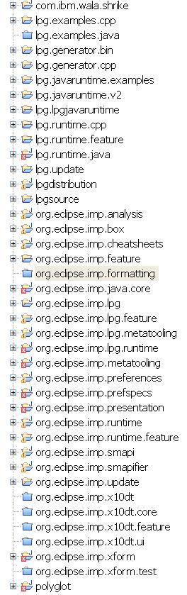

I did a checkout exactly the same way what you described below.But I am
getting a lot of errors.
"com.ibm.wala.shrike" dependency plugin not found for org.eclipse.imp.smpi
project.
please check the attached figure which shows the projects that are not
built.
Sandip
project.
built.
Sandip

Re: Missing IMP projects available [message #12296 is a reply to message #12272] Thu, 18 October 2007 12:33 Go to previous messageGo to next message
Sandip Sahoo wrote:
> Hi Stanley,
> project.
Hi there,
The "More of the Right Stuff" section is incomplete. You also need to get
com.ibm.wala.shrike from the WALA SVN repository at the following location:
http://wala.svn.sourceforge.net/svnroot/wala/trunk/com.ibm.w ala.shrike
Our apologies; we'll update the web page ASAP.
> built.

Thanks! I was able to solve the dependency of com.ibm.wala.shrike
But still not able to build the projects. please look into the attached
figure.

Hi Sandip,
Look at the IMP Developer's Corner page on the IMP web site:
http://eclipse-imp.sourceforge.net/developers/index.html
And check out the section "Building Required Parsers." From what I can
see in the image you sent, this should help you to address the problem.
To explain a bit here:
In the IMP CVS repository we don't usually store generated files that
can be regenerated in the user's workspace. (Of course, this saves on
storage space and download/upload time.) In particular, we don't store
the generated parsers and AST node types for the various languages
(e.g., DSLs) that are part of IMP. There are about half a dozen of
these languages now. The generated classes need to be regenerated
whenever one of the IMP projects that contains one of these languages is
checked out into a workspace.
Ideally, the LPG builder, which is part of the IMP installation, will
run automatically to regenerate the needed classes. However, there is a
problem in that the LPG builder does not seem to run automatically on a
project until after LPG has been run manually on the project. So, for
now, the IMP developer needs to manually run LPG on the grammar files
for each of these languages in order to get the containing projects to
build for the first time. The instructions on how to do this are
contained in the web page cited above.
We know this is a pain, and we apologize. We have to go through the
same process ourselves. We are working to fix it.
Stan Sutton

Re: Missing IMP projects available [message #14679 is a reply to message #12389] Mon, 29 October 2007 09:23 Go to previous messageGo to next message
Originally posted by: sandip.sahoo1980.gmail.com
Hi Stanley,
Can you please provide me an update on this?
Sandip
"Stanley Sutton" <suttons@us.ibm.com> wrote in message
news:ffftor$3b2$1@build.eclipse.org...
> Hi Sandip,
> In the IMP CVS repository we don't usually store generated files that can
> be regenerated in the user's workspace. (Of course, this saves on storage
> space and download/upload time.) In particular, we don't store the
> generated parsers and AST node types for the various languages (e.g.,
> DSLs) that are part of IMP. There are about half a dozen of these
> languages now. The generated classes need to be regenerated whenever one
> of the IMP projects that contains one of these languages is checked out
> into a workspace.
> Ideally, the LPG builder, which is part of the IMP installation, will run
> now, the IMP developer needs to manually run LPG on the grammar files for
> each of these languages in order to get the containing projects to build
> for the first time. The instructions on how to do this are contained in
> We know this is a pain, and we apologize. We have to go through the same
> Regards,
> Stan Sutton
>> figure.

Re: Missing IMP projects available [message #14710 is a reply to message #14679] Tue, 30 October 2007 17:24 Go to previous message
Hi Sandip,
With the Eclipse review for IMP coming up shortly and some other things
going on we haven't been focused lately on fixing bugs. Even so, I took
a look at this again and believe I have found and fixed the problem,
which affected the class org.eclipse.imp.lpg.builder.LPGBuilder in the
project org.eclipse.imp.lpg.runtime. I don't know when there might be a
new release to the update site, but the code with the fix is available
in the CVS repository.
Stan
Hi Stanely,
project.
built.
Sandip

Sandip Sahoo wrote:
> Hi Stanley,
> project.
Hi there,

Re: Missing IMP projects available [message #567948 is a reply to message #12296] Sat, 20 October 2007 14:36 Go to previous message
figure.
"Robert M. Fuhrer" <rfuhrer@watson.ibm.com> wrote in message
news:47178ACC.40402@watson.ibm.com...
> Sandip Sahoo wrote:
>> Hi Stanley,

Re: Missing IMP projects available [message #568046 is a reply to message #12354] Sun, 21 October 2007 12:12 Go to previous message
Hi Sandip,
Stan Sutton

Re: Missing IMP projects available [message #568747 is a reply to message #14679] Tue, 30 October 2007 17:24 Go to previous message
Hi Sandip,
Stan
