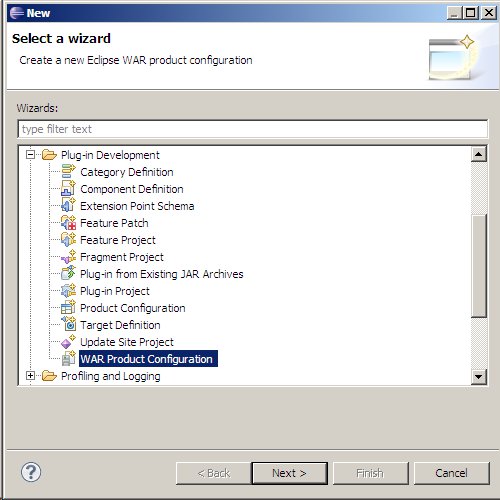

Re: Is there a tutorial? [message #824614 is a reply to message #824598] Mon, 19 March 2012 17:52 Go to previous messageGo to next message
Hi Roy,
I have to admit that I had to refresh on that subject. But it is still simple - I guess. I am using the Indigo release. Create your RAP project using the "RAP Mail Template". Then create a .warproduct configuration file by New\Other\Plug-in Development\WAR Product Configuration. Go to the Configuration TAB of the .warproduct. Click "Add Required Plug-ins". Right click on the .warproduct and choose export.
That's its. You will get a war file with a web.xml. I think you can adjust the web.xml in the .warproduct file. At least there is a TAB which displays the web.xml. Haven't played with it myself, though.
Good luck
Thorsten

Re: Is there a tutorial? [message #824624 is a reply to message #824617] Mon, 19 March 2012 18:10 Go to previous messageGo to next message
On 3/19/2012 2:52 PM, Thorsten Schlathölter wrote:
> Hi Roy,
> Good luck
> Thorsten

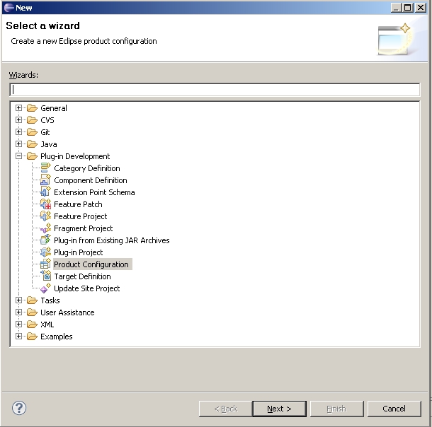

I have a Product Configuration pick but not a WAR Product Configuration
pick. I think without the ability to create a WAR product Configuration
one can't get there from here... I even downloaded Eclipse for RCP and
RAP developers again... sheesh, what's with this? I think this should
be easy not Rocket Science or something.
Thanks for the help! Any suggestions welcome. I think you've already
written better instructions than any tutorial I've seen (none included
even a mention of any of this).
Roy
Re: Is there a tutorial? [message #824638 is a reply to message #824624] Mon, 19 March 2012 18:27 Go to previous messageGo to next message
Hm. It's explained in the eclipse help. Search for warproduct.
And here is my platform information:
Eclipse for RCP and RAP Developers
Version: Indigo Service Release 1
Build id: 20110916-0149

Re: Is there a tutorial? [message #824651 is a reply to message #824638] Mon, 19 March 2012 18:38 Go to previous messageGo to next message
I was afraid of that... as I wrote, I don't have a choice...
The latest Indigo for RAP must be broken.... I'm attaching my view of
the same dialog. Just no such pick.
I really wanted to get some people started on RAP here but as it stands
I can't suggest that, at least not now.
Ideas ?
Thanks!!!
Roy
  • Attachment: product.jpg
    (Size: 82.31KB, Downloaded 298 times)
Re: Is there a tutorial? [message #824903 is a reply to message #824651] Tue, 20 March 2012 04:05 Go to previous messageGo to next message
Hi all,
WAR Product is part of the Libra project [1]. Get it from there.
[1] http://www.eclipse.org/libra/
Best,
Ivan
