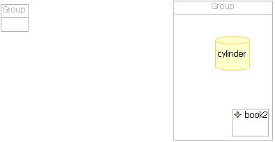

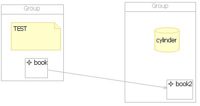

Link disappears after collapse compartment (1/1) [message #101179] Mon, 05 February 2007 22:00 Go to next message
Originally posted by: zwen.qilinsoft.com.cn
