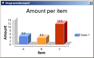

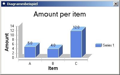

I have a simple chart, amount per item (see attached chart1.jpg).
Chart1.jpg shows the chart I got from BIRT using the chart wizard.
But I want to have a different color for each bar (each item A, B and C) as
shown in chart2.jpg (colors changed by an imaging program)
Using the wizard I can only modify color for different series (under
Y-Series within the chart wizard).
But in my chart I have only one serie. I did not find any way to color
single bars in my chart on only one serie.
How can I achieve this?
Thanks a lot!

Go to Layout->Legend screen in the chart builder, and choose 'Categories'
under Item Type. That will color the chart by categories, and the legend
will change accordingly.
We have changed the position and name of this setting in the new builder for
BIRT 2.0, so it will be easier to find.
David

Thanks, that's what I need!
