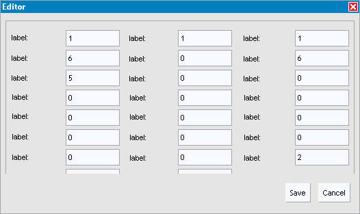

I came across a strange problem in my application. I have a dialog (jface)
with several text boxes and labels inside it (like 3 rows of text boxes).
The first time I open the dialog the 3rd line text boxes are croped by half.
I close it and open it again and everything is fine. If I shutdown the
application (equinox) and run it again, it appens again. It's not a problem
with a specific dialog because it happens on the others too.
This is using Firefox. Also I'm running this application standalone in
equinox (not inside Eclipse).
I send an attached snapshot with the problem.
Any ideas?
Tiago

I guess this is a problem with textsize determination and dialogs. The
textsize determination can only take place on the client side, so the
first time a text occurs in an application the system have to make an
educated guess. So if your dialog opens the first time the text sizes on
the it are all estimated. RAP automatically calculates the correct sizes
returns them to the server recalculates the layout and update the
client. The sizes of the calculated texts are stored on the server, so
the next time the texts are needed to correct size is available.
(see also http://wiki.eclipse.org/WidgetToolkit, Text size calculations)
Ciao
Frank

Originally posted by: fappel.innoopract.com
great - half of my explanations were cut off by sending the answer (grr!).
Note that this storage works over session boundaries, to understand how
please refer to the link I mentioned in my previous post.
The problem with dialogs is that the Dialog size gets calculated to fit its
content. So the recalculation of the Dialog's size doesn't take place at the
moment, which leads to the clipping of the dialog's content area you've
encounter. Note that this doesn't happen very often on a running system
(why? - this should be described also in the document the link refers to).
Ciao
Frank

Hi Frank,
Thanks for you reply. I've narrowed the problem down to my custom theme.
There is probably some issue with the font sizes I'm using. I'm going to
take a deep look and post the results later.
Thanks again.
Tiago

I was using Trebuchet MS as the font for my widgets, changed it to
Tahoma and all was fine.
Tiago
