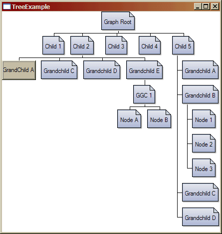

Has anyone already implemented or plan to implement an organization chart
layout algorithm for draw2d? This is one of our 2.2 line items (2.2 is many
months out, btw), but we would like to understand the use scenarios, and/or
receive contributions and testing from the community. See the attached
image.
  • Attachment: orgchart.GIF
    (Size: 19.13KB, Downloaded 145 times)

one usage scenario that i know would be useful in my app is layouting the
chart in a similar way to the way a tree is seen in the tree viewer, i.e.,
there is a root, you can either collapse or expand parent nodes, and no
two elements are found in the same vertical location.

This can be done already by using a "hozontal" tree with all nodes set to
"hanging" layout style. A test case is in the draw2d.examples project.
But, it sounds like what you want is a Tree widget that let's you paint
whatever you want, correct? I think it would be great if custom
tables/trees/etc used IFigure as the renderering mechanism.

Originally posted by: sy_cheung2.yahoo.com
Randy,
I have integrated the Tree Layout from GVF http://gvf.sourceforge.net/ with
GEF (one of the 2.1 release not the final 2.1 release).
Sam
set
> > to
> project.
> paint

If someone want to play with such tree widget and TreeViewer you may look
into code attached.
as
  • Attachment: Tree.zip
    (Size: 12.01KB, Downloaded 145 times)

Alex, this looks really cool! I think people can immediately understand it
because it uses simlar architecture to SWT's Tree. But, this means it has a
similar limitation of the SWT Tree. In order to display a Tree with 100,000
items, you must instantiate 100,000 TreeItems. No doubt it is probably an
order of magnitude faster since instantiation your items doesn't require
JNI. Any benchmarks?
