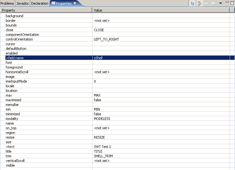

I'm new to Eclipse and SWT. I'm playing with the Visual Editor.
I have a simple class that contains a Shell. I want to set its layout.
So I select the Shell in the Java Beans view and the Properties
Editor shows a bunch of properties. However 'layout' is not one
of the properties shown!
Why isn't the 'layout' property shown?
properties.png - Image showing the properties editor for my Shell.

Re: layout property not shown for Shell [message #70777 is a reply to message #70767] Tue, 09 November 2004 11:18 Go to previous messageGo to next message
Originally posted by: richkulp.us.NO_SPAM.ibm.com
Use Java 1.4.2. 1.4.1 has a problem with BeanInfo that causes a conflict.
Rich Kulp
Re: layout property not shown for Shell - FIXED [message #70861 is a reply to message #70777] Tue, 09 November 2004 13:01 Go to previous message
Upgrading JRE from 1.4.1 to 1.4.2 solved the problem. Thanks!
