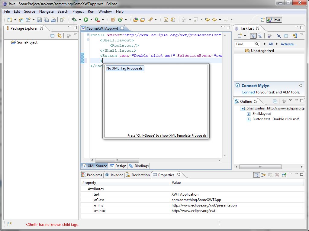

I am trying to edit an xml document with an associated .xsd schema in Eclipse.

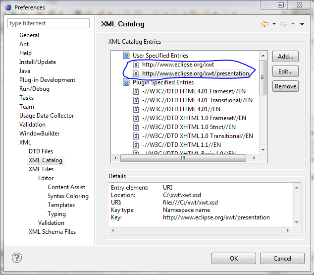

I clicked Window -> Preferences, and I selected XML -> XML Catalog, and I added the two .xsd files to my User Specified Entries.
index.php/fa/2846/0/
Then in my xml file, I typed open tag and ctrl-space, and I expected to see xml element suggestions from the schema I had added, but instead I saw no suggestions.
index.php/fa/2847/0/
The schema files and xml file are attached.
Are my expectations incorrect? Did I add the schemas incorrectly to my catalog? I appreciate any feedback.
> Eclipse.
did you make sure that your schema is valid? How do you reference it in
your xml file (namespace declaration, schemaLocation)?
I see only a big blob of "crap" (using Thunderbird) - seems the
attaching failed. Or does it work when using the web frontend?
Best regards
Wolfgang
Re: xml autocomplete from schema [message #675796 is a reply to message #674383] Wed, 01 June 2011 10:30 Go to previous message
What happens when you open in XML file in the regular XML editor instead of the embedded XWT editor?
