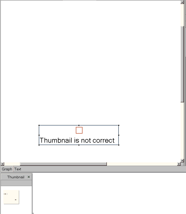

I am trying to use the draw2d ScrollableThumbnail to show a thumbnail of a
figure that is zoomed using the ZoomManager. The issue appears to be that
the same scale used for the viewport depiction in the thumbnail is being
used for the figure drawing. What ends up happening is that the viewport is
drawn in the correct location relative to the figure, but the figure is not
drawn scaled correctly. Also since ScrollableThumbnail is declared final
it makes it difficult to work around the issue. Any thoughts on how to fix
or workaround without duplicating much of the ScrollableThumbnail code in a
new class.

Re: Problem using ScrollableThumbnail with ZoomManager [message #66672 is a reply to message #66651] Wed, 26 February 2003 18:49 Go to previous message
It is a viewport associated with a ScalableRootEditPart, which is being
displayed in the thumbnail. I have zoomed the display using the ZoomManager
and when I do so the SrollableThumbnail displays the viewport image
appropriately, but draws the rest of the figure as if it were not zoomed. I
have attached a picture of a graph with a 2x zoom. One figure is on
visible, but there are two figures on the graph. Notice that the
thumbnail below the graph is showing the viewport as if both figures are
within view.
If the ScrollableThumbnail was not final or better yet accepted a
ZoomManager so it could account for the zoom level of the underlying figure
it would be great. I can open a bugzilla report if that would be the
easiest way to track the issue.
Thanks in advance.
