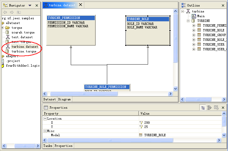

Maybe you can try use EMF(www.eclipse.org/emf) as you model framework,
I write an eclipse plug-in for Torque(db.apache.org/torque). My editor use
two
file as input, see attachments, turbine.torque has the information of the
database struct,
and turbin.dataset hold the information of the diagram and the relationship
of the
database model! use EMF, handle cross document references is easy!
Eric
