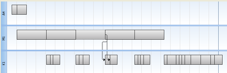

I want to show specific connections when a user clicks on a GanttEvent.
Of course I have to remove/hide the old ones, how can I do this? I tried
disposing all connections, but this yields a NPE. I changed the source
accordingly (set the GanttConnection's parent), but is there another
way?
this is what I do (essentially):
Collection<GanttConnection> connections = new
HashSet<GanttConnection>();
connections.addAll(ganttChart.getGanttComposite().getGanttCo nnections())
for (GanttConnection conn : connections)
conn.dispose();
n times:
ganttChart.addConnection(parentEvent, childEvent);
I I call this twice, I get an NPE at the conn.dispose() line
Manuel

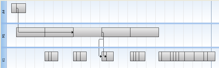

Re: Gantt: remove Connections [message #64939 is a reply to message #64900] Mon, 22 June 2009 07:55 Go to previous message
Hi Emil,
I attached a modified ConnectionExample-snippet. Works with your latest
nightly, not with the stable version though (where the GanttConnection
class does not exist yet as a public class).
To remedy the npe I did this to the GanttConnection package constructor:
GanttConnection(GanttComposite parent, GanttEvent source, GanttEvent
target,
Color color)
this._parent = parent;
this._source = source;
this._target = target;
this._color = color;
showOnlyDependenciesForSelectedItems is almost what I want, but I am
more flexible if I create the connections on the fly (see attached
screenshots)
(Although I'm not sure yet which connection-display-mode will actually
suit my needs better, showOnlyDependenciesForSelectedItems may also be
better performance-wise, if performance should ever be an issue.)
Greetings,
Manuel
