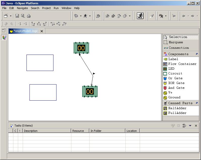

I try your suggestion, but I am able to bend the line if I draw a connection
between 2 LEDs.
But if I draw a connection between 2 MyFigure (the rectangles), the
connection is not connected at all. Only a small black traingle show up in
the Editor. (Please refer to the attached Screen shot).
