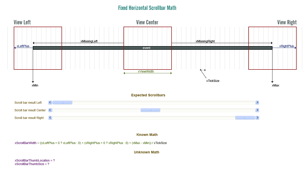

Hi Matt,
I'm currently trying to fix the "fixed range" scrollbar, but it's proving to
be extremely difficult to get right. If you're interested I've attached a
picture simplifying the math needed to calculate the correct "range", and
some remaining issues.
So, it's being worked on but I don't have a timeframe right now apart from
as soon as possible.
Emil

Hi Matt,
Emil
