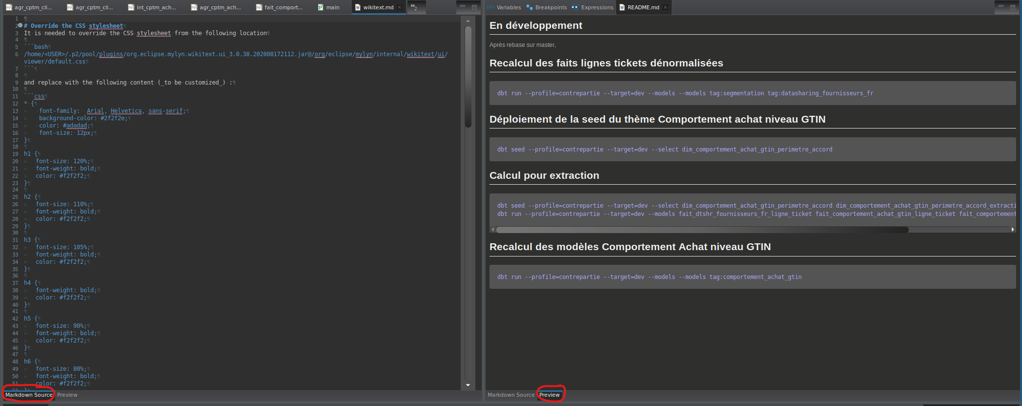

Re: WikiText background [message #1843196 is a reply to message #62577] Mon, 19 July 2021 15:09 Go to previous message
If you need to setup dark theme color scheme for Markdown files, you should configure both the editor and the viewer with similar colors.
For the viewer
for markdown preview, "simply" edit the CSS resource :
/org/eclipse/mylyn/internal/wikitext/ui/viewer/default.css
inside the jar file of the Eclipse plugins
/home/<USER>/.p2/pool/plugins/org.eclipse.mylyn.wikitext.ui_X.Y.Z.DDDDDDDDDDDD.jar
and replace with the following content
(to customize) :
	 font-family:  Arial, Helvetica, sans-serif;
	 background-color: #2f2f2e;
	 color: #adadad;
	 font-size: 12px;
h1 {
	font-size: 120%;
	font-weight: bold;
	color: #f2f2f2;
h2 {
	font-size: 110%;
	font-weight: bold;
	color: #f2f2f2;
h3 {
	font-size: 105%;
	font-weight: bold;
	color: #f2f2f2;
h4 {
	font-weight: bold;
	color: #f2f2f2;
h5 {
	font-size: 90%;
	font-weight: bold;
	color: #f2f2f2;
h6 {
	font-size: 80%;
	font-weight: bold;
	color: #f2f2f2;
b {
	font-weight: bold;
strong {
	font-weight: bold;
i {
	font-style: italic;
cite {
	font-style: italic;
	background-color: #bad0e6;
em {
	font-style: italic;
mark {
	background-color:yellow;
var {
	font-style: italic;
dfn {
	font-style: italic;
code {
	font-family: monospace;
	color:#ababff;
	background-color: #545454;
pre {
/* Java stack traces
pre.javaStackTrace {
/* sections beginning with -- Error Details --
pre.eclipseErrorDetails {
ins {
	text-decoration: underline;
del {
	text-decoration: line-through;
sup {
	font-size: smaller;
	vertical-align: super;
a {
	color: blue;
sup a {
	text-decoration: none;
sub {
	font-size: smaller;
	vertical-align: sub;
dt {
	font-weight: bold;
blockquote {
	color: rgb(38, 86, 145);
tt {
q {
h1.editorPreview, h2.editorPreview, h3.editorPreview, h4.editorPreview {
  padding-bottom: 0.3em;
  font-size: 1.75em;
  border-bottom: 1px solid #eee;
pre.editorPreview {
  padding: 16px;
  overflow: auto;
  line-height: 1.45;
  border-radius: 3px;
table.editorPreview {
  border-collapse: collapse;
  border-spacing: 0;
  border-color: grey;
tr.editorPreview td.editorPreview {
  border:1px solid #ddd;
  padding: 6px 13px;
tr.editorPreview th.editorPreview {
  padding: 6px 13px;
For the editor
To stay aligned with your dark theme color patterns applied to the editor must aslo adapt the viewer colors.
Edit the file in your workspace metadata folder like below :
/home/<USER>/eclipse-workspace/.metadata/.plugins/org.eclipse.core.runtime/.settings/org.eclipse.mylyn.wikitext.ui.prefs
And replace with the following content :
block-bc=font-family\: monospace; color\: \#569cd6; background-color\: \#2f2f2e;
block-bq=color\: rgb(38,86,145); background-color\: \#2f2f2e;
block-dt=font-weight\: bold; background-color\: \#2f2f2e;
block-h1=font-size\: 120%; font-weight\: bold; color\: \#569cd6;  background-color\: \#2f2f2e;
block-h2=font-size\: 110%; font-weight\: bold; color\: \#569cd6;  background-color\: \#2f2f2e;
block-h3=font-size\: 105%; font-weight\: bold; color\: \#569cd6;  background-color\: \#2f2f2e;
block-h4=font-weight\: bold; color\: \#569cd6;  background-color\: \#2f2f2e;
block-h5=font-size\: 90%; font-weight\: bold; color\: \#569cd6;  background-color\: \#2f2f2e;
block-h6=font-size\: 80%; font-weight\: bold; color\: \#569cd6;  background-color\: \#2f2f2e;
block-pre=font-family\: monospace; background-color\: \#545454;
eclipse.preferences.version=1
org.eclipse.mylyn.wikitext.ui.customtemplates=<?xml version\="1.0" encoding\="UTF-8" standalone\="no"?><templates><template autoinsert\="true" context\="org.eclipse.mylyn.wikitext.ui.editor" deleted\="false" description\="document background" enabled\="true" name\="background">.{\n  background-color\: rgb(47,47,47);\n  color\: rgb(155,155,155);\n}</template></templates>
phrase-bold=font-weight\: bold;  background-color\: \#cccccc;
phrase-citation=font-style\: italic;  background-color\: \#cccccc;
phrase-code=font-family\: monospace; color\:  \#569cd6; background-color\: \#545454;
phrase-deletedtext=text-decoration\: line-through;  background-color\: \#cccccc;
phrase-emphasis=font-style\: italic;  background-color\: \#cccccc;
phrase-insertedtext=text-decoration\: underline; background-color\: \#cccccc;
phrase-italic=font-style\: italic;  background-color\:\#cccccc;
phrase-monospace=font-family\: monospace; background-color\: \#545454;
phrase-quote=color\: rgb(38,86,145); background-color\: \#cccccc;
phrase-span=\ background-color\: \#cccccc;
phrase-strong=font-weight\: bold;  background-color\: \#cccccc;
phrase-subscript=font-size\: smaller; vertical-align\: sub; background-color\: \#cccccc;
phrase-superscript=font-size\: smaller; vertical-align\: super; background-color\: \#cccccc;
phrase-underlined=text-decoration\: underline; background-color\: \#cccccc;
(see file attached for preview)
Hope it helps !
