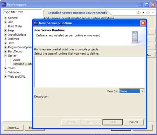

I still can not add any server runtime. Help please!
A snapshot is also attached.
Did you install just WST and not JST?
- Nitin

Originally posted by: mohsen_s.myrealbox.com
I have no JST.
I've just downloaded wtp-wst-sdk-1.0M2.zip and its dependencies (JEM, EDO, EMF,
....) and installed them.
Thanks.
P.S. Should I have JST?
I think so. Most of the runtimes I see with the full WTP SDK are
Java-related and would naturally fall within the JST part of the
project.
- Nitin
