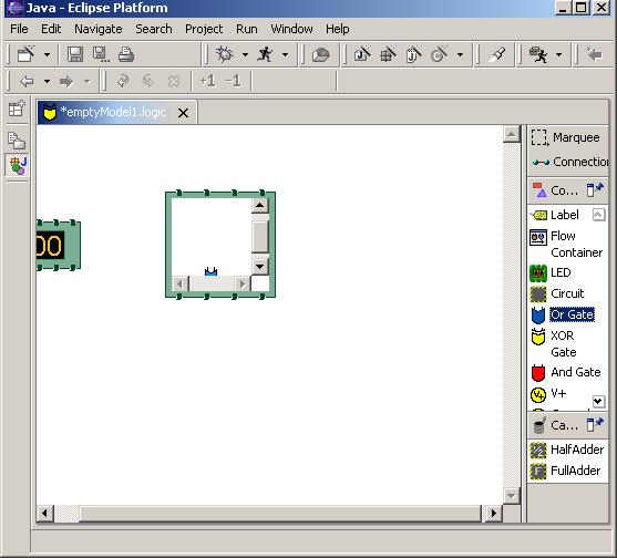

My understanding for the scroll bar in the logic editor example is the
hort/vert scroll bars will show up automatically if necessary. But what i
don't understanding is why both scroll bars show up when only one is
necessary.
In the attached diagram, why the vertical scroll bar for the diagram shows
up when only the hort scrollbar is necessary. And why the hort scroll bar
for the flow container shows up when only the vert scroll bar is necessary.
Thank for any feedback.

This has to do with the use of FreeFormLayer as the contents of the
Viewport. It is pessimistic to avoid making more than one layout pass. We
might be able to optimize this.
