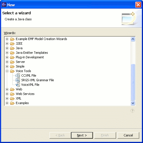

Re: not a lot of success on the first try [message #4879 is a reply to message #4810] Fri, 29 April 2005 17:45 Go to previous messageGo to next message
When you open Help->About Eclipse Platform->Plug-in Details, does the plugin
ID "org.eclipse.vtp.editor.vxml" appear in the list? That contributes the
wizard entry you should see. I installed the VTP from scratch on top of the
M3 WTP+GEF+EMF+etc build, Win32 build available here:
http://www.eclipse.org/downloads/download.php?file=/webtools /downloads/drops/S-1.0M3-200502260707/wtp-eclipse-prereqs-sd k-1.0M3-win32.zip&url=http://download.eclipse.org/webtoo ls/downloads/drops/S-1.0M3-200502260707/wtp-eclipse-prereqs- sdk-1.0M3-win32.zip&mirror_id=1
When I select File->New->Other.. the dialog that comes up has the voice
tools group. (Screenshot attached) An alternative to using the wizards is
just to create a new simple file (File->New->Other...->Simple->File) and use
the extension .vxml.
I'm curious, are you using the Win32 builds of WTP? I am not sure if we have
tested the contribution on other platforms.

Re: not a lot of success on the first try [message #4976 is a reply to message #4879] Fri, 29 April 2005 21:33 Go to previous messageGo to next message
Uh-Oh. My bad.
I overlooked the prerequisite statement, so I did not get the webtools
build first.
I will tackle that on Monday.
-- Mike

  • Attachment: dialog.gif
    (Size: 29.17KB, Downloaded 195 times)

Re: not a lot of success on the first try [message #571750 is a reply to message #4976] Tue, 03 May 2005 14:09 Go to previous message
Great! It worked as advertised when I got the webtools version installed.
-- Mike
Mike Greenawalt wrote:
