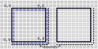

Re: Need help with ZOOM implementation [message #52061 is a reply to message #51905] Fri, 03 January 2003 11:25 Go to previous messageGo to next message
Originally posted by: hudsonr.us.eye-bee-em.com
Here is a picture that shows the problem. Notice that the "lighted" pixels
shown on the right side (at 200% zoom) do not touch the bounding box of the
figure.
  • Attachment: zoom.jpg
    (Size: 24.39KB, Downloaded 113 times)

Re: Need help with ZOOM implementation [message #52383 is a reply to message #52329] Sun, 05 January 2003 20:34 Go to previous messageGo to next message
"Bram Stieperaere" <bram.stieperaere@skynet.be> wrote in message
news:3E187C47.7050100@skynet.be...
> Randy,
> I think the algorithm should be something like (*both* for lines and
boxes):
> for both dimensions (hor/ver):
> - get minimum and maximum
> - scale minimum by simple multiplication with the zoom ratio
> - scale maximum using the "add 1, multiply, then substract 1"
procedure
This doesn't work for the case when I am trying to draw a "V":
drawLine(0,0,5,5);
drawLine(5,5,10,0);
using your zoom approach, then end of the first line and the beginning of
the second line would no longer touch when zooming in.
> the basic idea is to scale sizes, not coordinates:
> e.g. the horizontal line (0,0)-(9,0) has a size (S) of 10
Are we sure about that assumption? A horizontal line (0,0,0,0) looks like
it has no length to me, but it appears as 1 pixel on the screen. I think
"line width" needs to be interpreted as "pen diameter". If I set linewidth
to 5, and draw a zero-length line of width 5, I get a 5x5 dot. Therefore,
the last pixel in a line (and also the bottom and right edge of drawRect)
are really caused by the linewidth.
> S = max - min + 1
> after scaling with a ratio of e.g. 4 the size should be 40. more
> general, if we scale with a ratio R, and denote the transform with T,
> we expect T to satisfy
> R*S = T(max)-T(min)+1
> say
> T(min) = R * min
> then
> T(max) = ?
> after substitution we find that
> R*(max - min + 1) = T(max) - R*min + 1
> or
> T(max) = R*(max +1) - 1
> HTH
> Bram
Re: Need help with ZOOM implementation [message #52443 is a reply to message #52383] Mon, 06 January 2003 07:12 Go to previous message
Originally posted by: Bram.Stieperaere.REMOVEskynet.be
seems you'll have to base the algorithm on topological information then (if
you want to avoid scaling line thickness)
e.g. for each Figure determine whether one of its end points
is "on" or "touching" another Figure, then take in account the transform
should preserve this topology.
this could get tricky IMO.
Bram
"Randy Hudson" <hudsonr@us.eye-bee-em.com> wrote in message
news:avalsa$ola$1@rogue.oti.com...
> > Randy,
> boxes):
> procedure
> drawLine(0,0,5,5);
> drawLine(5,5,10,0);
linewidth
> > S = max - min + 1
> > say
> > T(min) = R * min
> > then
> > T(max) = ?
> > or
> > HTH
> > Bram
