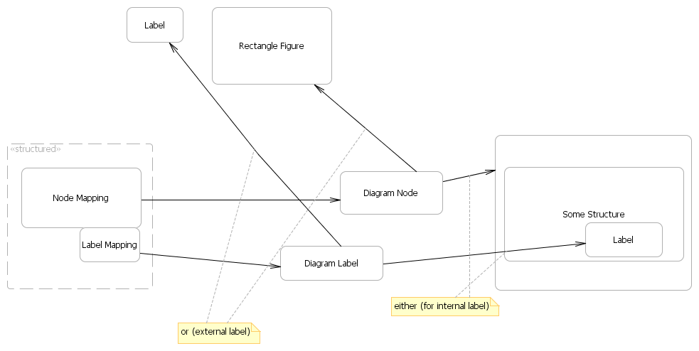

The explanation below is a bit complicated because the problem lies in the
relation between Node Mapping/Label Mapping in the map model, corresponding
Diagram Node/Diagram Label in the "diagram elements" part of the gmf graph
model and corresponding figures/labels in the "Figures" part of the gmfgraph
model. I am sorry that I can not explain this better.
In the gmfgraph you have CompositeStateFigure with child label
CompositeNameLabel.
You also have Diagram Label StateNameDiagramLabel that references _different
label figure_, in particular, the label form _different and unrelated
figures hierarchy_.
You also have diagram node that references CompositeStateFigure and
NodeMapping that references this diagram node.
Inside this mapping you also have Label Mapping that references that
UNRELATED StateNameDiagramLabel from the gmfgraph.
To fix compilation error you need to ensure that Label Mapping either:
1. Indirectly (via gmfgraph Diagram Label medium) references the
"uncontained" label (the one that is not inside any figure hierarchy, the
direct child of its FigureGallery) -- in this case this label will be
considered external.
2. Or indirectly references the label from the same figure hierarchy that
the figure indirectly referenced by Node Mapping (I guess that it should be
Diagram Label for "CompositeNameLabel") -- in this case the "inner" label
will be used with positions defined by figure hierarchy.
You may take a look at the attached diagram (also a bit cryptic)
Michael

Re: Missing methods in a generated Class [message #52931 is a reply to message #51238] Thu, 21 September 2006 09:39 Go to previous message
Originally posted by: dont.spam.net
Hi Michael,
thanks for the great explanation. It helped me a lot. The Statemachine
is running now. :)
Thanks!
Christian
Michael Golubev schrieb:
> Hi,
> CompositeNameLabel.
> figures hierarchy_.
> Regards,
> Michael
