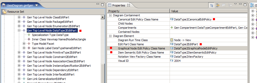

Re: Error during Code generation: "A resource exists with a different case" [message #49468 is a reply to message #49349] Sun, 17 September 2006 11:07 Go to previous messageGo to next message
You may fix it by setting the editpart/edit policies class names manually in
the gen-model editor (see attached screenshot).
However, after examining the code that produces default values I can not
explain why there may be default values with different cases. If possible,
please post your models (mapping + graph + tool) here for further
investigations.
Michael

Michael Golubev schrieb:
> Hi,
> investigations.
