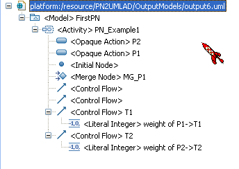

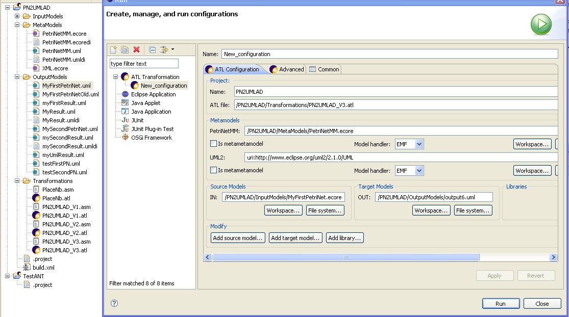

Hi everybody,
Following your Hugo's advices, I have just installed (from scratch)
-Eclipse 3.3 (Build I20070621-1340),
-EMF 2.3 (v200706251320)
-MDT-UML2 (v200706251652)
and from CVS, the latest version of ATL and AM3 plugins.
I have written a simple transformation from Petri Nets to UML Activity
Diagrams
When I run the transformation by the menu "Run->Open Run Dialog" using the
parameters you can see on the screenshot in attached file named "run
configuration.png" , I obtain the result I expected and I can open the
result with the UML editor (screenshot in the attached file
"expectedResult.png")
But, when I use the build.xml script (see atteched file) , I can't open the
> result with the UML editor. When I compare the 2 files I see
> 1) in the "good" result ("manual" run configuration) :
> <?xml version="1.0" encoding="ISO-8859-1"?>
> <uml:Model xmi:version="2.1" xmlns:xmi="http://schema.omg.org/spec/XMI/2.1"
> xmlns:uml="http://www.eclipse.org/uml2/2.1.0/UML"
> xmi:id="_28NZICS3EdyzOPBFDStLfg" name="FirstPN">
> <packagedElement xmi:type="uml:Activity" xmi:id="_28NZISS3EdyzOPBFDStLfg"
> name="PN_Example1">
> <node xmi:type="uml:OpaqueAction" xmi:id="_28NZIiS3EdyzOPBFDStLfg" name="P2"
> outgoing="_28NZKiS3EdyzOPBFDStLfg" incoming="_28NZKCS3EdyzOPBFDStLfg"/>
> <node xmi:type="uml:OpaqueAction" xmi:id="_28NZIyS3EdyzOPBFDStLfg" name="P1"
> outgoing="_28NZKCS3EdyzOPBFDStLfg" incoming="_28NZJyS3EdyzOPBFDStLfg"/>
> <node xmi:type="uml:InitialNode" xmi:id="_28NZJCS3EdyzOPBFDStLfg"
> outgoing="_28NZJSS3EdyzOPBFDStLfg"/>
> <node xmi:type="uml:MergeNode" xmi:id="_28NZJiS3EdyzOPBFDStLfg" name="MG_P1"
> outgoing="_28NZJyS3EdyzOPBFDStLfg" incoming="_28NZJSS3EdyzOPBFDStLfg
> _28NZKiS3EdyzOPBFDStLfg"/>
> <edge xmi:type="uml:ControlFlow" xmi:id="_28NZJSS3EdyzOPBFDStLfg"
> source="_28NZJCS3EdyzOPBFDStLfg" target="_28NZJiS3EdyzOPBFDStLfg"/>
> <edge xmi:type="uml:ControlFlow" xmi:id="_28NZJyS3EdyzOPBFDStLfg"
> source="_28NZJiS3EdyzOPBFDStLfg" target="_28NZIyS3EdyzOPBFDStLfg"/>
> <edge xmi:type="uml:ControlFlow" xmi:id="_28NZKCS3EdyzOPBFDStLfg" name="T1"
> source="_28NZIyS3EdyzOPBFDStLfg" target="_28NZIiS3EdyzOPBFDStLfg">
> <weight xmi:type="uml:LiteralInteger" xmi:id="_28NZKSS3EdyzOPBFDStLfg"
> name="weight of P1->T1"/>
> </edge>
> <edge xmi:type="uml:ControlFlow" xmi:id="_28NZKiS3EdyzOPBFDStLfg" name="T2"
> source="_28NZIiS3EdyzOPBFDStLfg" target="_28NZJiS3EdyzOPBFDStLfg">
> <weight xmi:type="uml:LiteralInteger" xmi:id="_28NZKyS3EdyzOPBFDStLfg"
> name="weight of P2->T2"/>
> </edge>
> </packagedElement>
> </uml:Model>

This "good" result is obtained because the model is serialized using the
UML driver (and extractor) whereas the "bad" result is obtained because
the model is serialized using the EMF driver (and extractor).
> 2) how to get the same (good) result with ant script?
You have to load the UML2 metamodel with the UML2 modelHandler (see
answer to your question 3) and to precise a path in the "outModel" markup:
<outModel name="OUT" model="targetUmlModel" metamodel="UML2MM"
path="/PN2UMLAD/OutputModels/${model}.uml">
and keep the call to the "saveModel" task as it is.
Doing this, it may works.
