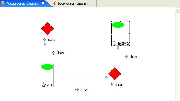

>I have a flow which can link with data and activity, the picture shows my
> model.
> I want to do such constrains:
> 1, activity can not connect with activity
> 2,data can not connect with data
> in other words, I don't want a node connect with another node with the
> same
> class type.
> what does the expression should I write in the "sourceEnd constraint" or
> "targetEnd constraint" in link constraint in gmfmap?
> can I get the class type of sourceEnd and targetEnd in ocl expression ?
> self.getClass() <> oppositeEnd.getClass()

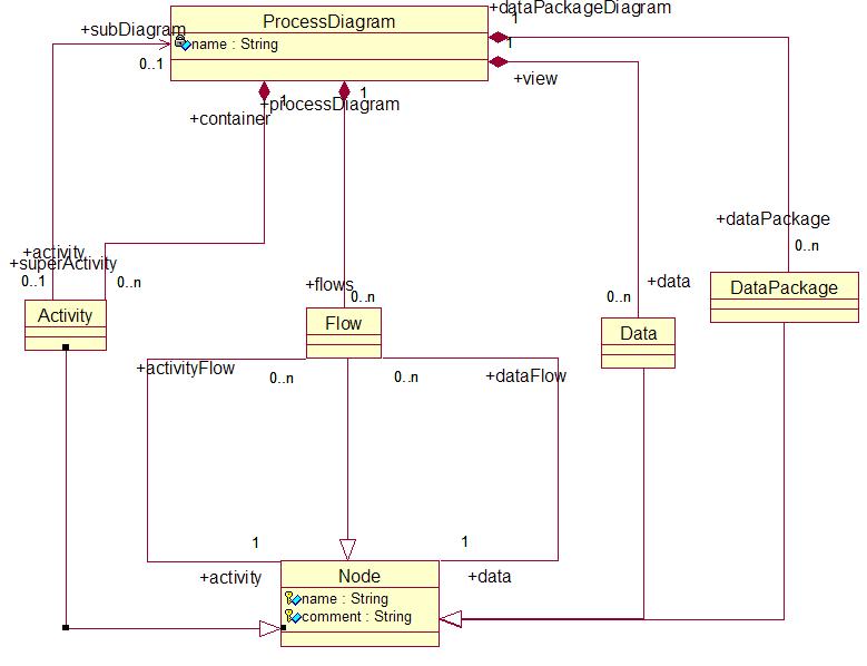

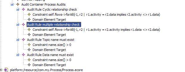

Re: OCL constrains [message #47000 is a reply to message #46882] Fri, 25 August 2006 12:49 Go to previous messageGo to next message
Originally posted by: dzhpingbo.sohu.com
"Radek Dvorak" <radek.dvorak@borland.com> д
  • Attachment: model.JPG
    (Size: 45.26KB, Downloaded 185 times)
  • Attachment: audit Rules.JPG
    (Size: 26.84KB, Downloaded 145 times)
  • Attachment: tmp.JPG
    (Size: 13.09KB, Downloaded 155 times)
Re: OCL constrains [message #47252 is a reply to message #47000] Mon, 28 August 2006 19:53 Go to previous message
Hi dzh,
Sorry, for the late response, I somehow overlooked your latest post.
As for your multiple connection constraint,
AFAIU you want to disallow multiple flows connecting to the same Data and
Activity node.
Try the following sourceEnd:
oppositeEnd <> null implies not self.subDiagram.flows->exists(f| f.activity
= self and f.data = oppositeEnd)
/Radek
