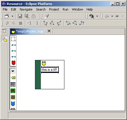

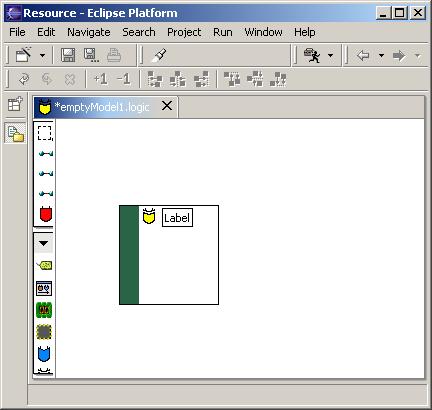

I put a label within a container using Flowlayout.
As I editing the label by putting more text in it, the location of the label
shift. Is it possible to prevent that?
Attached is the screen shot 1.jpg is the initial position, 2.jpg is the
shift position as I put more text.
Is it possible for me to change the container's size as I enter more text?
The DirectEditPolicy can get the host figure( in this case the label), but
can the directory edit policy get the container figure of the host figure?
Thank you.

It depends on the context of the figure and which layouts you are using.
In you example, create another Flow container that is really large, and put
the flow container from your example inside it.
Or, set your flow containers width and height to -1 using the property
sheet.
