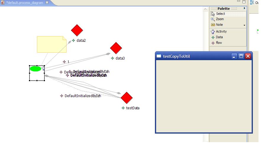

The code works well without reporting error, but I can not see anything from
the shell shows up....So I suspect if I did right?
By the way, I use the diagramEditPart which is returned by
copyToImageUtil.createDiagramEditPart method to get the commands to create
view on it, then how to save the Diagram? I know if it is an editor, I can
use editor.doSave(), but it is Ddiagram, how to save it back to its
diagramfile.
If there any example of using copyToImageUtil ? If rightly created, the
diagram should show up in the shell?
view on it, and I use resource.save(Collections.EMPTY_MAP) to save, but
after reopen the diagram file, I found nothing changed.
Best reagrds,
dzh

No, you shouldn't see the diagram in the shell. This method allows you
to create a DiagramEditPart without creating an editor. You could then
use the DiagramEditPart for whatever reason you needed it. For example,
GMF uses this mechanism to create an image from a diagram (see
CopyToImageUtil.copyToImage()).
Cherie
