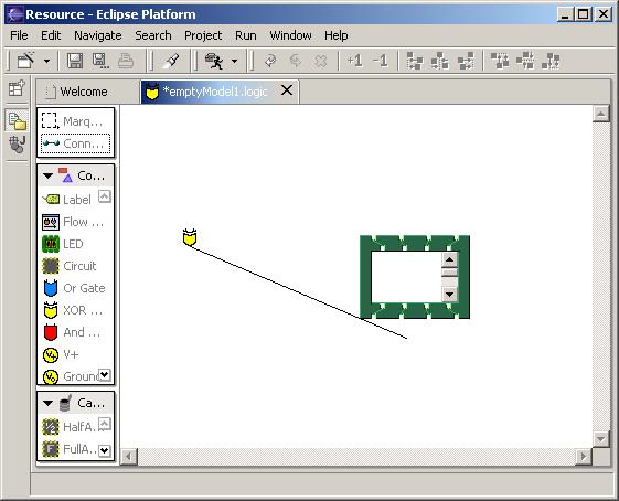

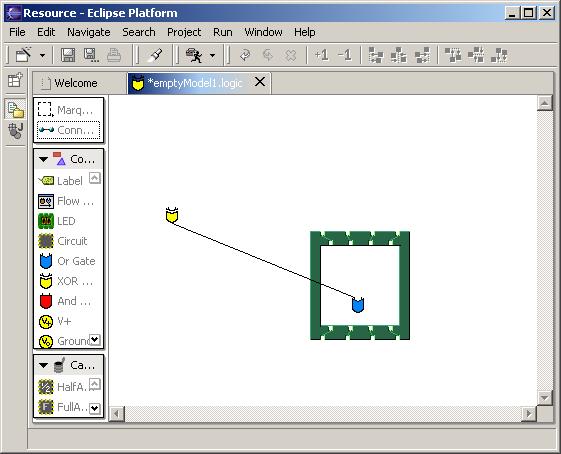

Originally posted by: radienssmgs2.hotmail.com
Basically, I want to avoid case show in the after.jpg.
In the beginning I have a connection to the Or Gate (before.jpg), but later,
I change the size of the Circuit so that Or Gate is not longer visible but
the connection between the Or Gate and XOR Gate still is. I would like to
make the connection between Or Gate and XOR Gate become invisible whenever
Or Gate becomes invisible.
Thank you.

Re: Control how components layout in a ScrollPane [message #38891 is a reply to message #38677] Sun, 03 November 2002 18:47 Go to previous messageGo to next message
Originally posted by: hudsonr.us.eye-bee-em.com
You could do this 2 ways. Does your application have connections from one
scrollpane to another? Or just within a a single scrollpane?
I'll assume you have connections across scrollpanes like in the Logic
example. ConnectionAnchor will already fire when the node figure's or any
of their ancestors move or resize. And, PolylineConnection will already
revalidate itself if this happens. So, all you need to do is override
validate() on the ConnectionFigure. Then, for each node at each end, take a
copy of the node's bounds, and walk up the parent hierarchy, as you go you
will 1) clip the bounds to the current ancestor's clientArea, 2) transform
that result to the next parent figure, since coordinate systems can change
as you go up. The exact code for this (except it is using getBounds()
instead of getClientArea()) is already in
DeferredUpdateManager.repairDamage(). Once you have clipped the Rectangle
to be isEmpty(), you know the figure isn't visible.
I think this is going to look weird. You might not want to walk all the way
up to the GraphicalViewer's Viewport, because then you will have
connection's flashing in and out as you scroll the entire diagram.
I've seen an alternative to this. Instead of having connections scroll down
in the middle of nowhere like in the Logic example, you could clip the
ConnectionAnchor to the top/bottom of the parent's scrollpane. So, once a
connection scrolls to the edge of the scrollpane, it stops there even though
scrolling continues.
