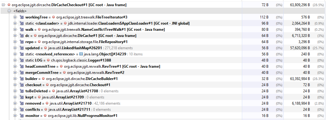

But jgit (7.0.0) runs out of memory on my microservice with -Xmx256m (it does so even if I do -Xmx350m)
It seems that DirCacheCheckout holds 57M in updated field, and 63M in builder.
Baseline for the microservice is about 85M, so it looks that to checkout this repo jgit needs more than ~160M.
Is there a way to improve memory usage or tell jgit a cache limit??
Re: Memory consumption for DirCacheCheckout [message #1871790 is a reply to message #1871787] Thu, 10 October 2024 18:43 Go to previous messageGo to next message
How can the updated hashmap end up with 271k elements when checking out 6.7k files (folders aren't tracked in the git index) ?
Can you retry and create a heap dump when the OOM strikes and analyze that using memory analyzer ?
