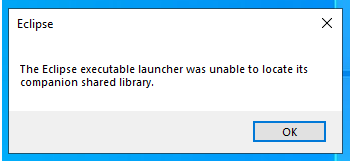

I installed eclipse and moved the shortcut to public so all users can execute the application, but unfortunately when other users try to launch it they receive the error below.

If you used the installer, read the What Else Should I Consider? section:
https://www.eclipse.org/setups/installer/question/
I.e., it's important to consider the location of the shared bundle when using one, which is the default.
If a package is sufficient, you could just unzip one:
