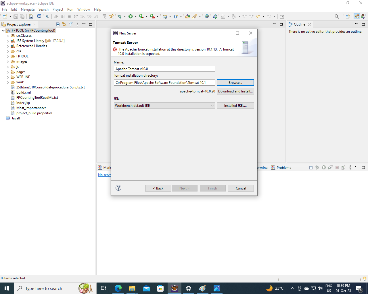

im facing an issue when i choose the path of my tomcat installation directory.
i get the below error and i have tried to rectify this error but im not able to rectify.Please have a look at the error .
Screenshot attached for reference

It seems pretty clear that you need to indicate the Tomcat 10.1 server type to use a Tomcat 10.1 installation.

Please goto https://tomcat.apache.org/download-10.cgi
and I have installed tomcat 10.1.13 itself
I do not find 10.0 tomcat installation there.
Please could you help me out

For older releases, click on the Archives link on the left. You could also let Eclipse download it for you using
the "Download and install" button, from your screenshot. Or select Tomcat 10.1 as the server type in the
previous page of the wizard. You appear to be using an older release before support for 10.1 was added
(possibly from before Tomcat 10.1 released), so perhaps an update is in order?
