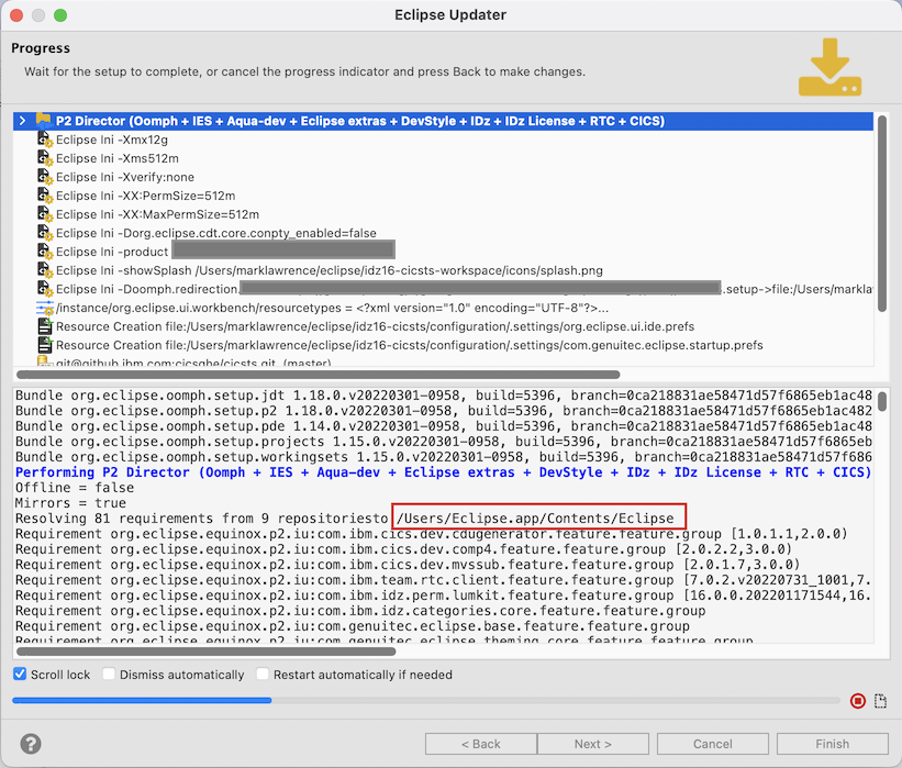

....but not quite. After restart, I found that the install had been broken. Lots of errors & missing requirements. Turns out that the 'Perform setup tasks' process isn't installing the requirements in the correct place (as if it forgets installation.location), rather than installing to:
/Users/<my user name>/eclipse/<product name>/Eclipse.app/Contents/Eclipse
it's choosing to install missing requirements to:
/Users/Eclipse.app/Contents/Eclipse
This is down to something I mentioned I was going to do in another post. I need the 'configuration' folder to be outside the Eclipse.app bundle so that I can sign the Eclipse.app bundle and the signature not be broken soon after loading Eclipse with a changing internal 'configuration' folder (this is so secure storage plays nicely on Mac with other Eclipse instances). I got that working by adding osgi.configuration.area=${installation.location/}configuration to the config.ini. However, Oomph doesn't do this straight away during install. A few things get written in the 'configuration' folder within the Eclipse.app bundle before the line gets added. One of those folders is 'org.eclipse.oomph.setup'. Anyway, as soon as I disable my config.ini modification task and re-install, everything works great.
Is what I'm doing regarding the move of the configuration folder ok to do? It seems Oomph might expect it in a certain place? Can I change the [b]configuration:[\b] value used in Oomph?
Is there a way I can correct this path being used? How is it calculated? Looks like it might decide where to install requirements based on relative path to the 'configuration' folder, maybe?

Re: 'Perform Setup Tasks..' P2 task doing more than I'd expect [message #1857768 is a reply to message #1857750] Fri, 24 February 2023 05:56 Go to previous messageGo to next message
These are very low level details, complicated further by the fact that I work on Windows where this isn't this rather complicated layout. Where Oomph wants to put things and find things like the Installation.setup is answered differently if your asking where does the installer put things versus where does a running application look for things. Certainly in the installer, Oomph expects a standard layout and will know nothing about you changing the configuration location. In the running application I would assume it looks in the configuration folder as specified by the osgi property. From what you describe, these sound like two different locations. If you search the source for Installation.setup you'll find related things. Also org.eclipse.oomph.setup.internal.core.SetupContext.getStaticConfigurationLocation() and org.eclipse.oomph.setup.internal.core.SetupContext.INSTALLATION_SETUP_URI are how the application finds things. But in the installer it does things like this:
      File configurationLocation = composedPerformer.getProductConfigurationLocation();
      if (configurationLocation != null)
        File installationLocation = new File(configurationLocation, "org.eclipse.oomph.setup/installation.setup"); //$NON-NLS-1$
which expects a standard layout...
Re: 'Perform Setup Tasks..' P2 task doing more than I'd expect [message #1857778 is a reply to message #1857768] Fri, 24 February 2023 20:02 Go to previous messageGo to next message
Thanks for info Ed. I had a look around at the code you suggested. I couldn't find any way of tricking the installer or the 'Eclipse Updater' to go the correct place. What I've been experiencing is the same as what's reported here: https://bugs.eclipse.org/bugs/show_bug.cgi?id=391455
I think the only way around it would require changes to oomph to allow the configuration folder to live outside the Eclipse.app bundle. The Mac notarisation process seems to be stricter even more in Ventura and plays havoc on blocking unsigned apps from accessing the OS keychain. Mac app bundles have to be immutable nowadays. From what I've seen, signed apps can access any entry in the keychain following admin approval, but unsigned apps can only access a keychain entry they've created. So having multiple unsigned Eclipses on a Mac is bad news.
I've readjusted my expectations a bit, a feature I'm installing comes with a password provider, so I'm planning on using that. The snag I have now is, its only available after BOOTSTRAP, so any password variables in my setups are always asked for at install time and the Eclipse Installer can't save those passwords using my new password provider, as it hasn't been installed yet.
Is there a way of getting oomph to ask for password variable entry at STARTUP?
I saw it would do this if the variable was undeclared, but that doesn't work with passwords because anything that uses them after entry errors because they're not encrypted and in base64.
