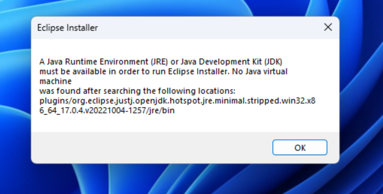

Depending on what I've changed, I can sometimes get this to appear (I can see this plugin in the zipped up customised tar before repackage, I'm not sure why it cannot see it)
index.php/fa/42915/0/

One detail that's easy to miss is that tar file must be in GNU format:
tar --format=gnu -cf ../${i%.zip}.tar *
Re: Cannot create customised Installer for Windows with bundled JRE [message #1857525 is a reply to message #1857519] Mon, 13 February 2023 13:38 Go to previous message
Thank you Ed, that was the missing piece!
I'm doing this on a Mac, so gnu isn't an option in tar. So I did it on a Linux machine, which does have that option.
Working great now!
