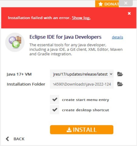

This is the error message.
Here is the log of what it told me.
  • Attachment: My project.jpg

You are probably behind a corporate firewall which is adding packets to the http traffic using a certificate that is not in the installer's embedded JRE's cacerts.
Based on this comment
https://bugs.eclipse.org/bugs/show_bug.cgi?id=567504#c28
it might work if you ran the the *.exe with "-vmargs -Djavax.net.ssl.trustStoreType=Windows-ROOT" from a command line.
It would be helpful to know if that actually works.
Or you can download a package
But that package will have the same network problem so you will not be able to update it or install new things into it...
