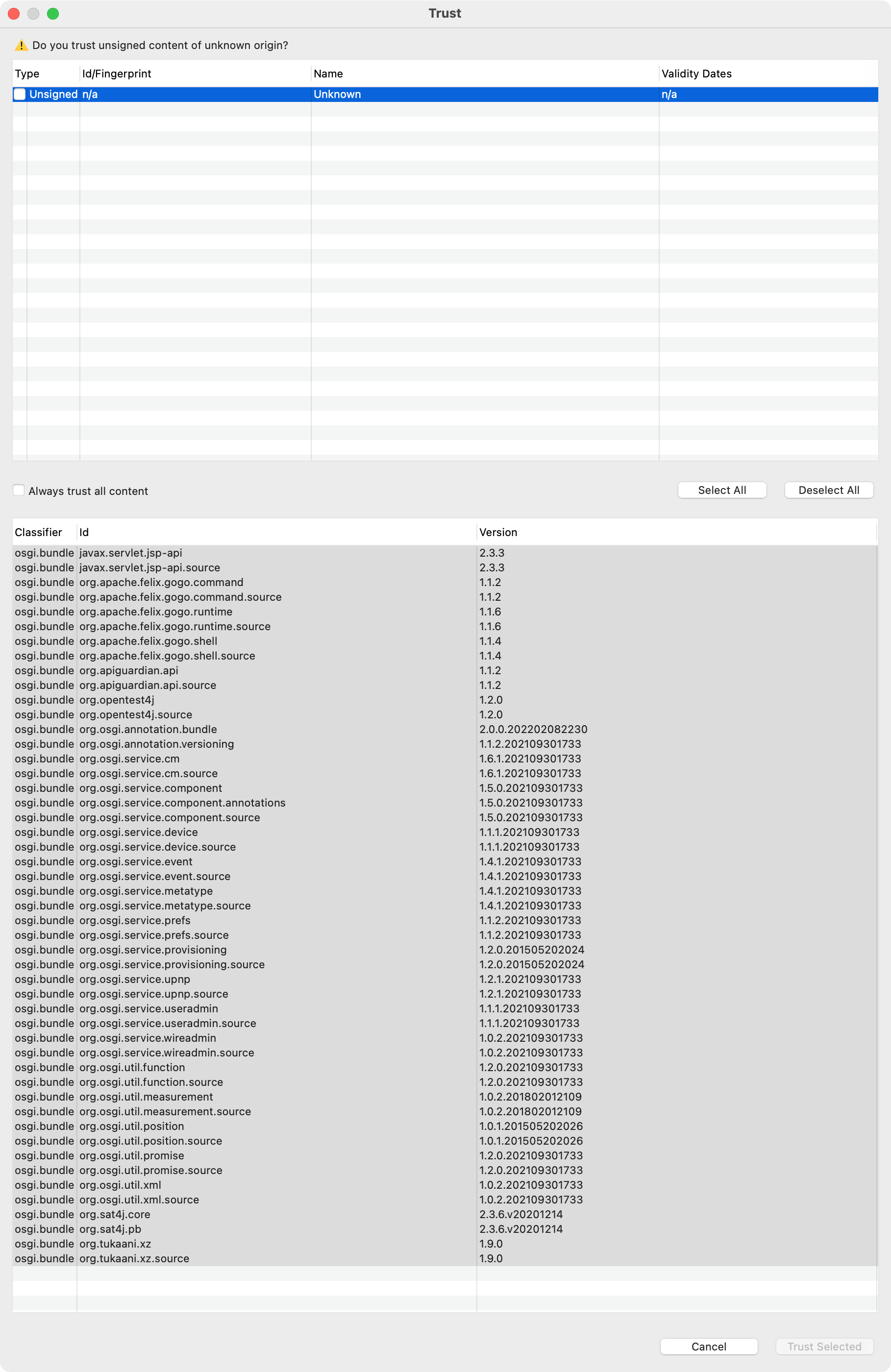

I tried installing 2022-12 versions of Eclipse Modeling Tools and Eclipse IDE for Eclipse Committers and they both yielded warnings about unsigned content.
index.php/fa/42794/0/
Is there a known problem with the release or is it an issue in my setup?
I'm on macOS Ventura 13.1 (Intel) and I used the latest Eclipse Installer from eclipse.org.
