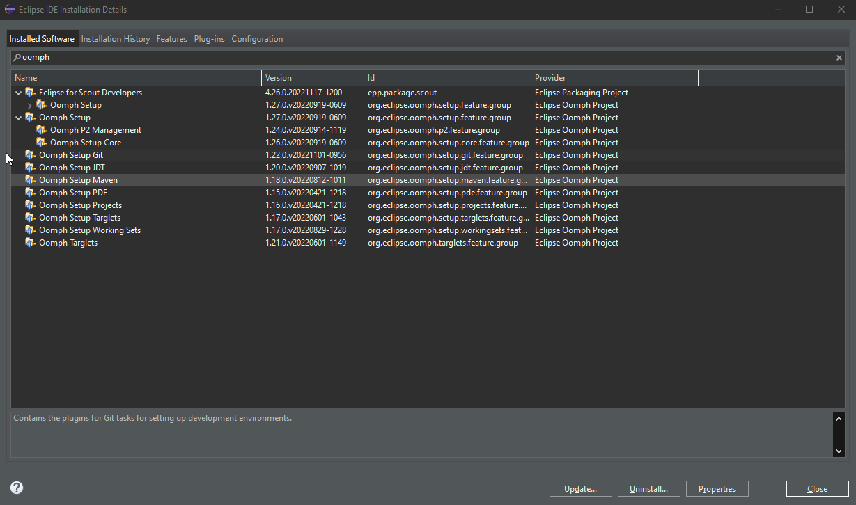

The installed Oomph Setup Git Plugin ist built at the same version timestamp as the oomph commit, indicating it should have it included (assuming the version timestamp uses the timestamp of the latest commit).

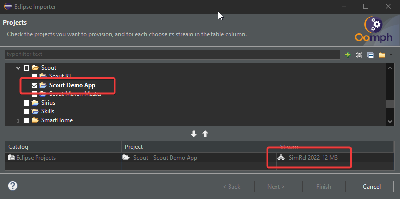

Re: CheckoutConflictException in Oomph GitCloneTask since 2022-12 M2 [message #1856146 is a reply to message #1856141] Wed, 23 November 2022 03:37 Go to previous messageGo to next message
Thank you for answering so quickly! I definitely should clean up old releases from the Oomph file. It should checkout features/version/22.0.37 from https://github.com/bsi-software/org.eclipse.scout.docs.git when using the settings as in the following screenshot.
index.php/fa/42734/0/
