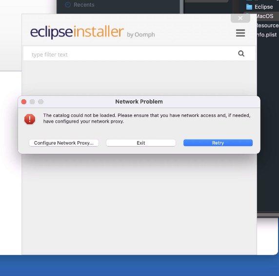

Hi Team,
Good Day to you...
We are trying to install eclipse IDE through jamf application. Error screenshot attached.
We downloaded .dmg file from the below location.
kinldy suggest us with your input.
Ranjana
  • Attachment: eclipse.png
    (Size: 65.41KB, Downloaded 161 times)
Re: Issues Eclipse DE [message #1851127 is a reply to message #1851114] Mon, 28 March 2022 08:41 Go to previous messageGo to next message
As I mentioned here, I cannot reproduce that problem so I cannot fix it:
https://www.eclipse.org/lists/eclipse-ide-wg/msg00137.html
E.g., your problem is similar to this one, which I also cannot reproduce:
https://bugs.eclipse.org/bugs/show_bug.cgi?id=539304
Re: Issues Eclipse DE [message #1851162 is a reply to message #1851127] Tue, 29 March 2022 07:05 Go to previous message
I expect your problem is likely to be exactly like this one:
https://bugs.eclipse.org/bugs/show_bug.cgi?id=578341#c23
I.e., that your corporate proxy introduces its own certificate into the network traffic and that that certificate is not known to the Java runtime. The above comment describes how someone worked around the issue.
