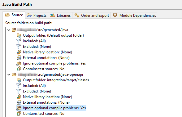

We have a larger number of modules in our project with different generated source folders.
Is there a possibility to enable the option "Ignore optional compile problems" for other folders in addition to the source directory src/generated/java?
Here is a example screenshot:
index.php/fa/41537/0/

That information is stored in the .classpath file of each project for each source folder like this:
	<classpathentry kind="src" path="xtend-gen">
		<attributes>
			<attribute name="ignore_optional_problems" value="true"/>
		</attributes>
	</classpathentry>
There are no tasks specifically for modifying the .classpath resource of a project if that's what you're asking. I suppose a Text Modify task could do such editing, but this seems to me to be something you should set manually once and for all time.
