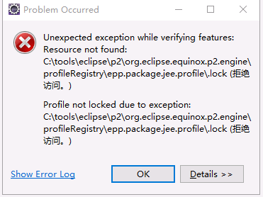

I have installed eclipse (version: 2021-09 (4.21.0)) on Windows server 2016 use administrator account.
now other user login the server open the eclipse will display error. and can't install plugin. how do i config to make everyone can install their owner plugin?
Error message:
org.eclipse.oomph.util.ReflectUtil$ReflectionException: java.lang.IllegalStateException: Profile not locked due to exception: C:\tools\eclipse\p2\org.eclipse.equinox.p2.engine\profileRegistry\epp.package.jee.profile\.lock (Access denied。)

Re: How to make multi user work on 1 server [message #1847355 is a reply to message #1847336] Mon, 25 October 2021 01:03 Go to previous messageGo to next message
Did you install using the installer or by unzipping a packaged download?
Re: How to make multi user work on 1 server [message #1847457 is a reply to message #1847355] Wed, 27 October 2021 22:39 Go to previous messageGo to next message
i use unzip package. not the install.
Re: How to make multi user work on 1 server [message #1847513 is a reply to message #1847457] Sat, 30 October 2021 01:53 Go to previous message
Normally, as long as the installation folders ares fully read-only, a surrogate installation/profile is created in the user's home folder...
