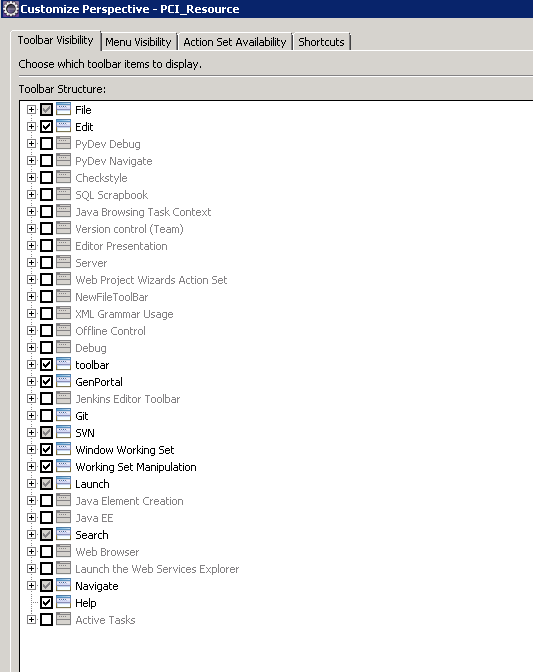

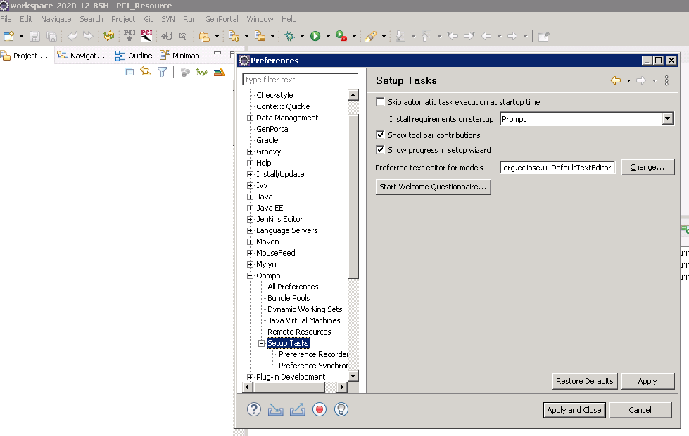

The preference is set and the preferences pages are still there. In most cases the Editor contribution for Setup files and Repository Explorer are also still there.
The Setup toolbar entries, and OS Tool contributions (like System Explorer) and missing though. I can't find anything in the various Error and workspace logs though. If there is anywhere/thing in particular I can dump to help troubleshoot let me know.
