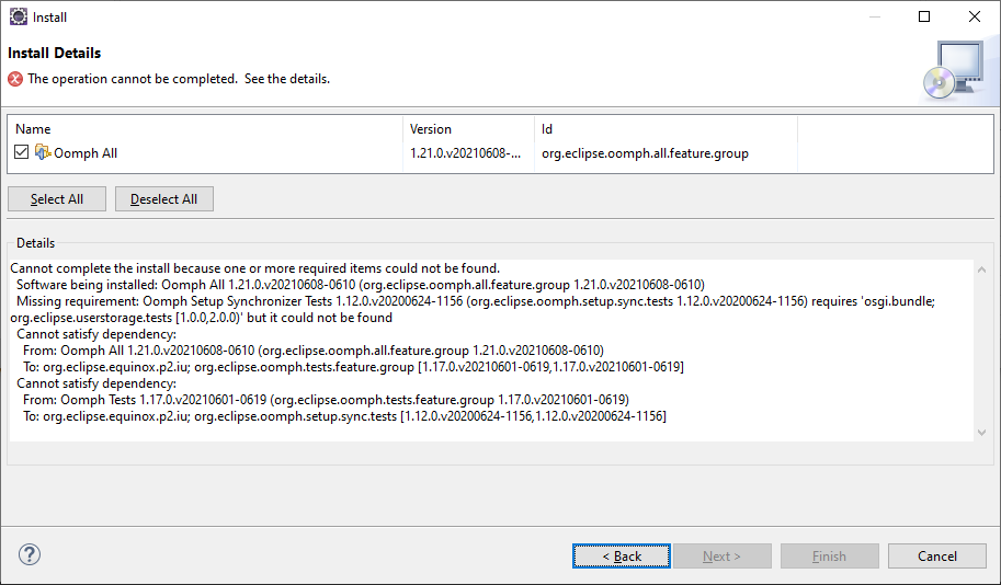

is there a way for me to resolve this on my end? Installing "Oomph All" into jee-latest-released (2021-06) fails with:
Cannot complete the install because one or more required items could not be found.
  Software being installed: Oomph All 1.21.0.v20210608-0610 (org.eclipse.oomph.all.feature.group 1.21.0.v20210608-0610)
  Missing requirement: Oomph Setup Synchronizer Tests 1.12.0.v20200624-1156 (org.eclipse.oomph.setup.sync.tests 1.12.0.v20200624-1156) requires 'osgi.bundle; org.eclipse.userstorage.tests [1.0.0,2.0.0)' but it could not be found
  Cannot satisfy dependency:
    From: Oomph All 1.21.0.v20210608-0610 (org.eclipse.oomph.all.feature.group 1.21.0.v20210608-0610)
    To: org.eclipse.equinox.p2.iu; org.eclipse.oomph.tests.feature.group [1.17.0.v20210601-0619,1.17.0.v20210601-0619]
    From: Oomph Tests 1.17.0.v20210601-0619 (org.eclipse.oomph.tests.feature.group 1.17.0.v20210601-0619)
    To: org.eclipse.equinox.p2.iu; org.eclipse.oomph.setup.sync.tests [1.12.0.v20200624-1156,1.12.0.v20200624-1156]
TIA
Daniel

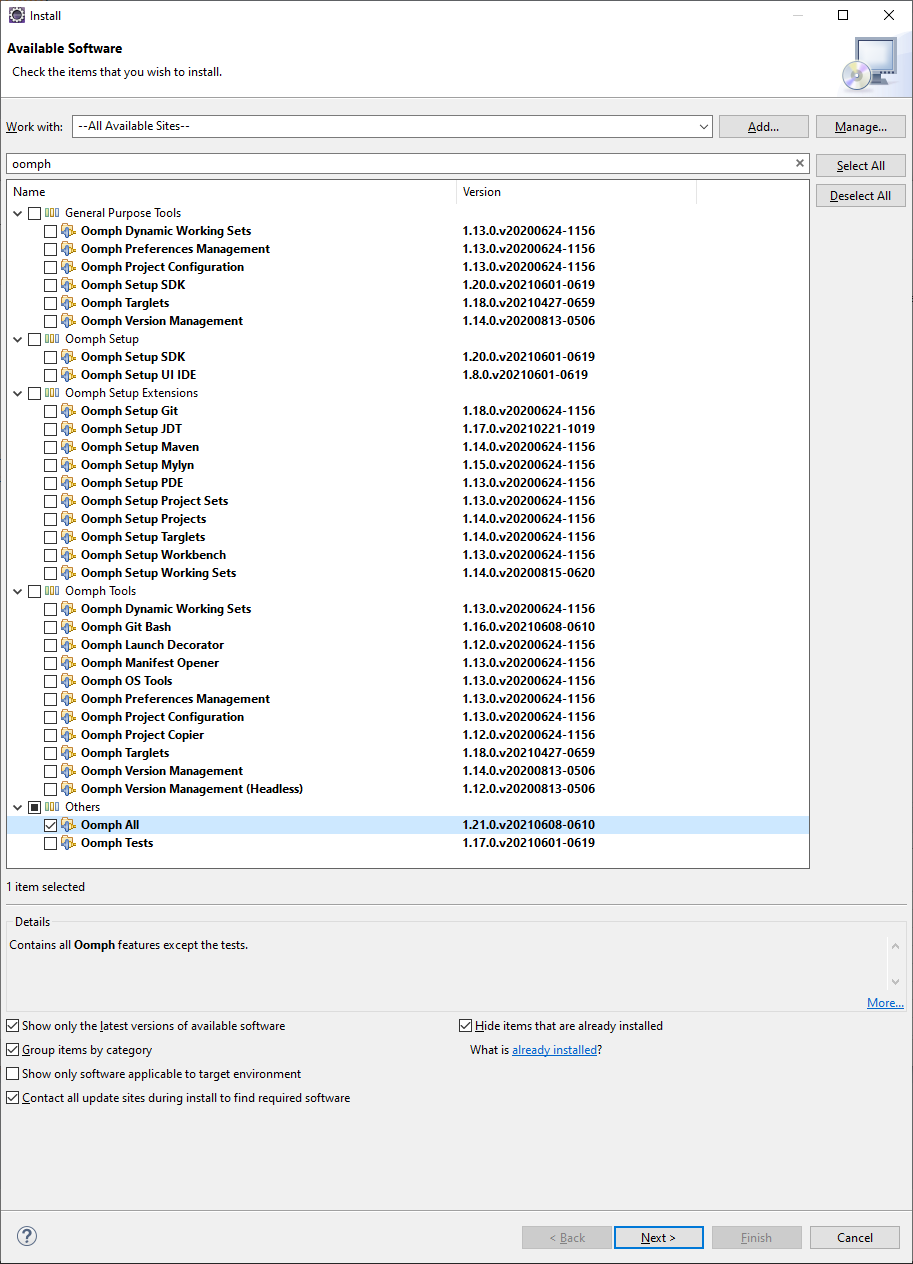

P.S.: moar background:
I just re-read my post from 6 years ago which motivated me to play around with oomph again. (btw, gutfeelings 1+2 mostly were nonexisting or very shallow, 3 sadly was a bit mis-stated by myself and is still existing in some way ... i probably will address that sometimes soon-ish in an post of its own)
So i installed a fresh jee-latest-released (via oomph - in a breeze - which i came to like the oomph installer very very much for - through the last ~6 years), and afterwards tried this:
- Help/Install new Software
- Select "Work with: --All Available Sites--"
- Search for oomph
- select "Oomph All", and Next like this:
index.php/fa/40695/0/
- watched the 1 to 15 steps of trying to resolve somthing which resulted in this
index.php/fa/40696/0/
Re: 2021-06 - "Oomph All" installation fails [message #1842647 is a reply to message #1842644] Sat, 26 June 2021 09:40 Go to previous message
I would suggest that you not install org.eclipse.oomph.all.feature.group because this is just there to help build a complete update site that includes tests. It might be useful for provisioning a target platform if you are extending Oomph, but it is not something you should install in an IDE because you should not install tests in an IDE. This is why it's not in any nice category. Choose the SDK feature.; it pulls in most of the rest. The Preferences Management feature is a nice to have too, if you want to analyze what preferences are all available and how they are stored.
