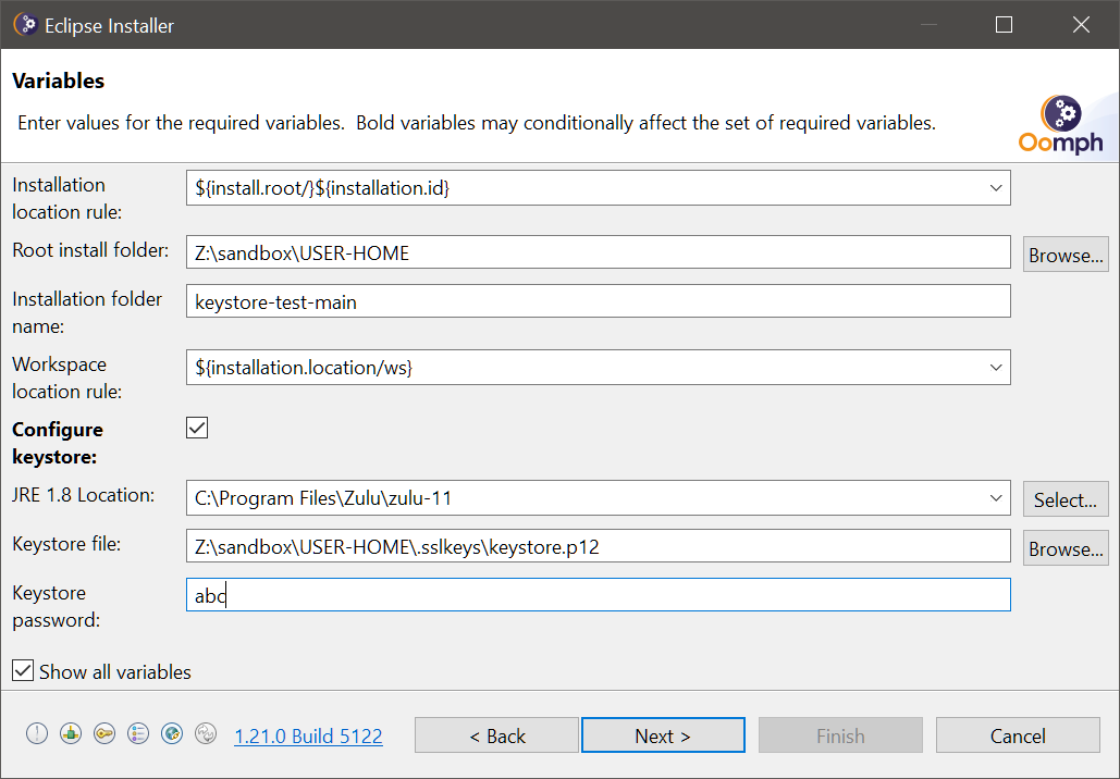

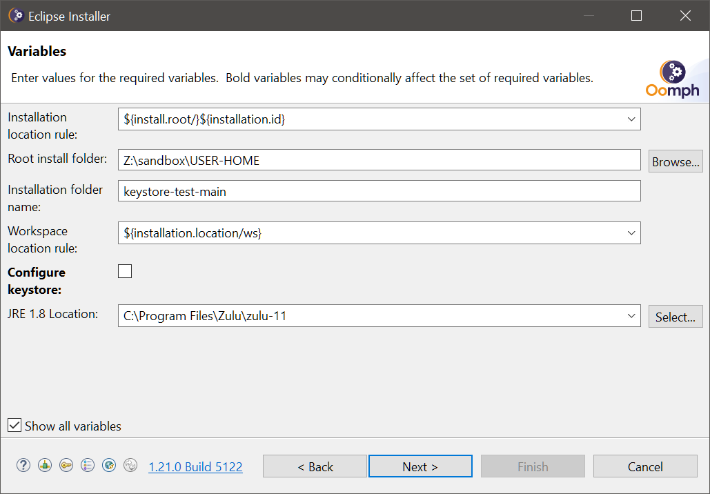

Variables screens:
index.php/fa/40556/0/
index.php/fa/40557/0/

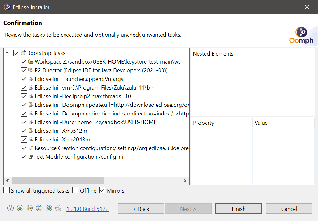

Confirmation screen (configuration selected without restart):
index.php/fa/40558/0/

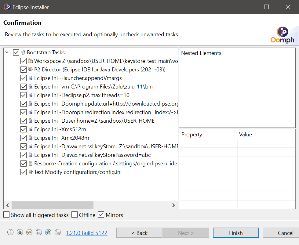

Confirmation screen (configuration with restart):
index.php/fa/40559/0/

It just works for me, both in the debug launch from my Oomph development workspace and launching from the command line with the 2021-06 M3 installer:
https://www.eclipse.org/downloads/packages/release/2021-06/m3
I see it creates the fake user home folder and that the task are present on not depending on the check box both initially and the next time...
